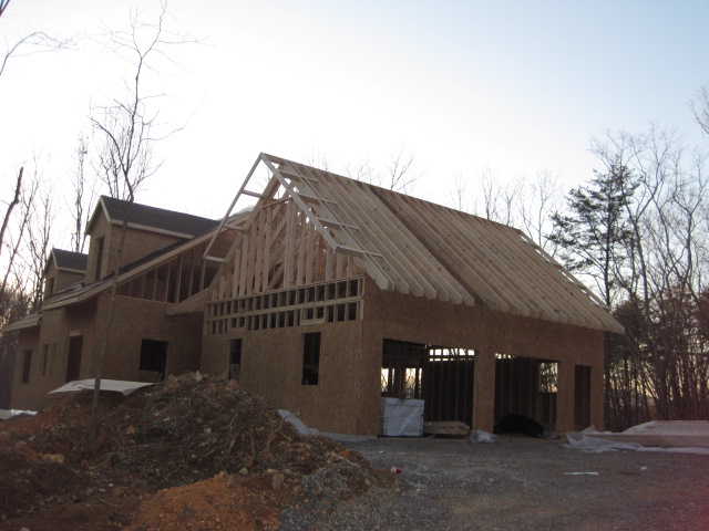

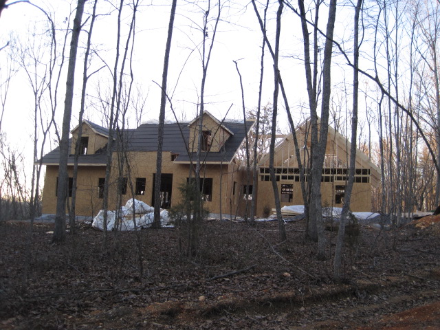

Today work was done on framing the garage rafters. Also, supplies were delivered and placed in the garage instead of in the parking area in front of the garage. Yay! It has been getting old trying to keep the supplies from being put in the parking areas.
