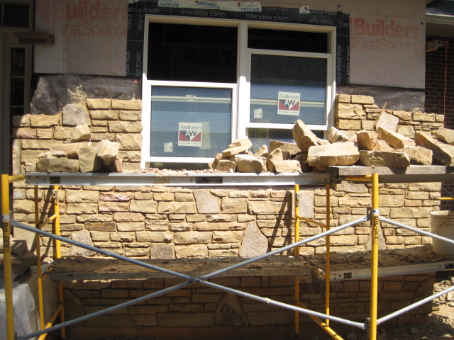

For new construction, who normally installs the windows? Does the framer normally install them or do professional window companies usually install them?
   / At Home In The Woods #896
Framer.
   / At Home In The Woods #897
Yes, the framers do this. Be sure they do it right. I've seen way too many just nail them up and not seal them or use tape. Be sure the wrap is cut and the flap goes on the outside of the window, then seal with tape.
Take a picture of what the do, it's real easy to see if it's done correctly.
Eddie
   / At Home In The Woods #898
Around here the framers used to do it all the time, kind of a freebie thrown in the last day.
However, leaking windows is a potential nightmare of mold and rot. So it is now more common for either the general or a window company to handle the install. To do it right can cost a fair amount in sealants, window pans and flexible tapes etc. But it is money well spent.
   / At Home In The Woods #899
Yes, it's usually the framers job to install the windows and exterior doors. And, most of them do a really lousy job of it. Make sure they do as mentioned with the seal tape, caulk, etc. Go behind them with a level and square. Make them fix anything and everything now before the brick/siding goes on. This is one of those items that can haunt a house from now on if it''s not done correct now.
Also, make sure the exterior doors are shimmed and long screws are used through the hinges into the framing. Use the levels, squares on them as well.
You are doing a great overseeing your house. I wish all the contractors I work for had the same desire as you to get things done properly.
