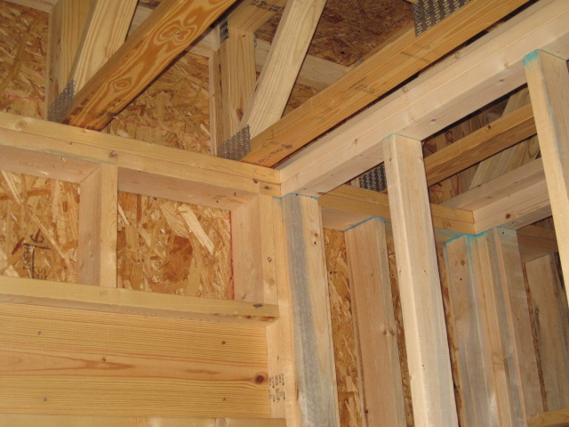

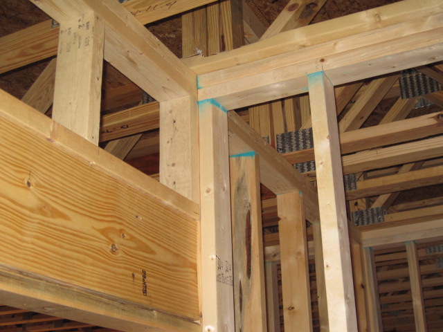

Double top-plate interiror wall question
The framer has built several interior walls. I noticed some spots at the wall intersections that the double top-plates do not overlap but the dead wood is used to do the overlapping. Is this ok? If it is not ok, what issues will it cause?
Thanks, Obed

In my opinion all top plates should overlap, but I don't know what code is. Just my opinion. I think it would make for stronger walls. Of course those look to be non-loadbearing walls.

The way he did it is just fine and is the way I always did it. If you think about it, what is there to gain by crossing the double plate when you can cross the drywall nailer/backer like he did.

Technically, it is incorrect.
The reason for the over laping second top plate is so you can toe nail up threw
the opposite side of the perpendicular walls top plate and suck the two walls together. This is important on exterior wall corners, probably not as important on smaller interior walls.
That said, as long as the fit is tight and the backing plate is nailed on with more than two nails, its probably fine.

If I am correct in assuming that you are talking about the space between the trusses and the top plate, If it wasn't more than 1 1/2inch I wouldn't worry about it. When you install the drywall, first to be installed will be the ceiling, when the walls are installed,they will be butted against the ceiling, holding up the ceiling drywall.
What I WOULD be concerned about is whether the trusses are sitting directly over the trimmer/wall studs to carry the load directly down to the foundation.
BTW I don't think it is good practice to try and "suck" up
any variation between framing members when one of them is a truss. What you might end up with is a wall portion being "hung" off a truss. Not a good idea IMHO.

I've never seen or heard of anybody not overlapping the top plates. It's such a basic rule of thumb that it goes beyond what I understand. Have you passed your framing inspection? I'd ask the inspector is it's ok and go with what he says.
Having said that, I would insist that he attach a blocking plate for the sheetrock on the ceiling at every corner just like he did in the dirt picture. It would provide the same strength as the overlapping top plates are designed to do, and also give your sheetrock on the ceiling a better fit.
With the movement of the walls during the life of the building, I don't know if I would want to rely on the studs holdling together without a top plate there to really lock them into place. It might be overkill, but then how hard is it to do it right the first time? or to add a third plate to the top and make sure it's secure?

I'd say the way he did it is usually not acceptable. Overlapping the top plate will give you a stronger more stable structure. I would say its ok (but less than ideal) to not overlap the top plate as long as the end stud can be nailed into a stud on the perpendicular wall, or if he adds horizontal blocking between the studs on the perpendicular wall for the end stud to nail into.
What does your building inspector say about it? Although I've never seen anyone not overlap the top plate I'm sure the my local inspectors wouldn't pass it. That's pretty basic stuff. I'm amazed at the shortcuts some people take.

It won't hurt to add scrap piece of 2 by you have laying around on the top and tie in the 2. a scrap piece 2 feet or so is better then nothing. I am sure you got some scrap pieces laying around. I doubt it the builder will take the time, but you are the owner so go around and start tieing the walls. makes for a stronger house in event of disaster.
