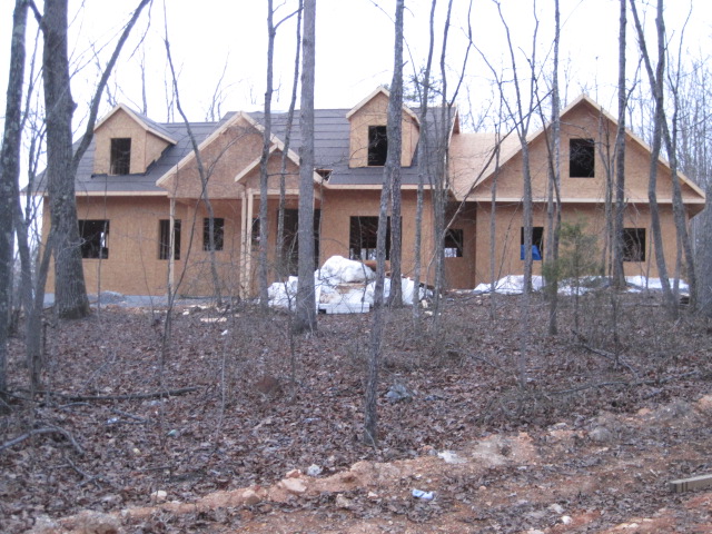

The outside stone work is done.
attachment.php
We really liked the stone mason so we have hired him to lay the stone on the fireplace in the living room. We used real stone on the outside. We will be using cultured (fake) stone for the LR fireplace. Real stone weighs significantly more than cultured stone. If we had used real stone, we would have needed to pour footers in the basement and laid a concrete block wall in the basement to support the stone in the living room. That's why we went with cultured stone in the LV fireplace; it was much simpler.
The stone mason did all the work himself; he didn't have any helpers. Several of our subcontractors (i.le. the owners) did not do much, if any, of the labor but had their hired hands do all the work. Quite a few of the subs we hired rarely were on site. We have noticed a correlation regarding how much the owner is on site and the quality of work and number of mistakes. The quality of the work on our job performed by the subcontractors who have become solely managers and salesman has been noticebly worse that the work of the subcontractors who actively work alongside their employees. This observation has not been universal; the vinyl subcontractor did not do any of the actual work but we were pleased with his company's work. But the vinyl subcontractor was the exception, not the rule.
