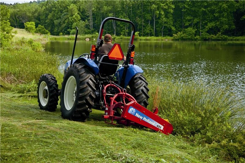

Sickle bar mower ? Otherwise, have fun building, would love to see result as I have same issue...

I mow driving across the pond bank now, from (close to, not too close though) the waterline up to about 3/4 the way up the bank, then it gets too steep for my pucker factor and I back up the hill at that spot. I used to mow it all up and down but it takes forever.
Mowing sideways it's anywhere from 15-20* on my tilt meter on the tractor. Down by the water it's 15* which is fine. However, I don't want to put a lot of heavy weight like a sickle mower hanging off the down hill side. I figured the push mower deck would be much lighter, even more so with a counter weight on the other side.
The majority of weight on a sickle mower is low and behind the tractor. IMHO running a tractor and whatever twenty some inch deck is a very inefficient way to get the job done. You would need to make 4 to 5 passes to equal the cutting width of a sickle mower and the sickle mower would be able to cut right into the water.

Again, I think your best bet, after looking at the pictures of the terrain/pond, would be a 6-7 foot sickle bar...if you just like building/tinkering, buy a used beat up sickle bar and restore it...anyway, whatever you come up with I'm interested...got much the same at Casa De Rich...

I vote for the sickle bar also. Get one that uses a belt instead of a pitman arm to run the sickle. The pitman won't give you near as much angle up and down.
