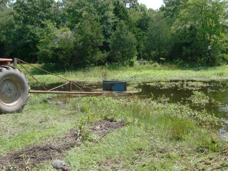

My biggest problem was water primrose out in the pod where a mower would not help so I built a big rake.

I don't mind, I got the idea here. If you do a search for pond rake you can find one built out of 2x4's and rebar. The one I built was boiler pipe and 3/4" cold rolled.
I will say the extra bracing was done after it failed.
Once it was dropped to the bottom and pulled out, on the first run, all looked well until the weeds looped over the rake and added too much weight and bent it.
Trussed up it will hold the weight but the desk top welded across the rake to keep the weeds from being able to loop over was the fix and it likely would have worked just fine IF we put it on to start with.
A few more pics here. http://s121.photobucket.com/user/jmorrismetal/library/farm?sort=3&start=all&page=1

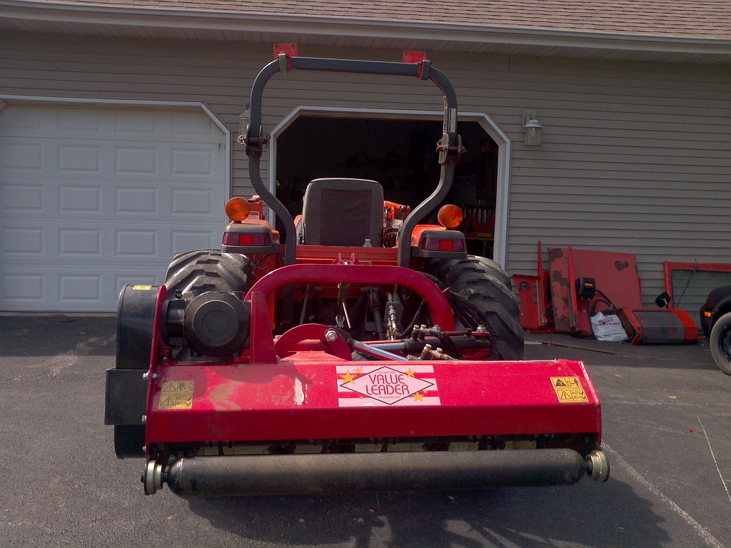

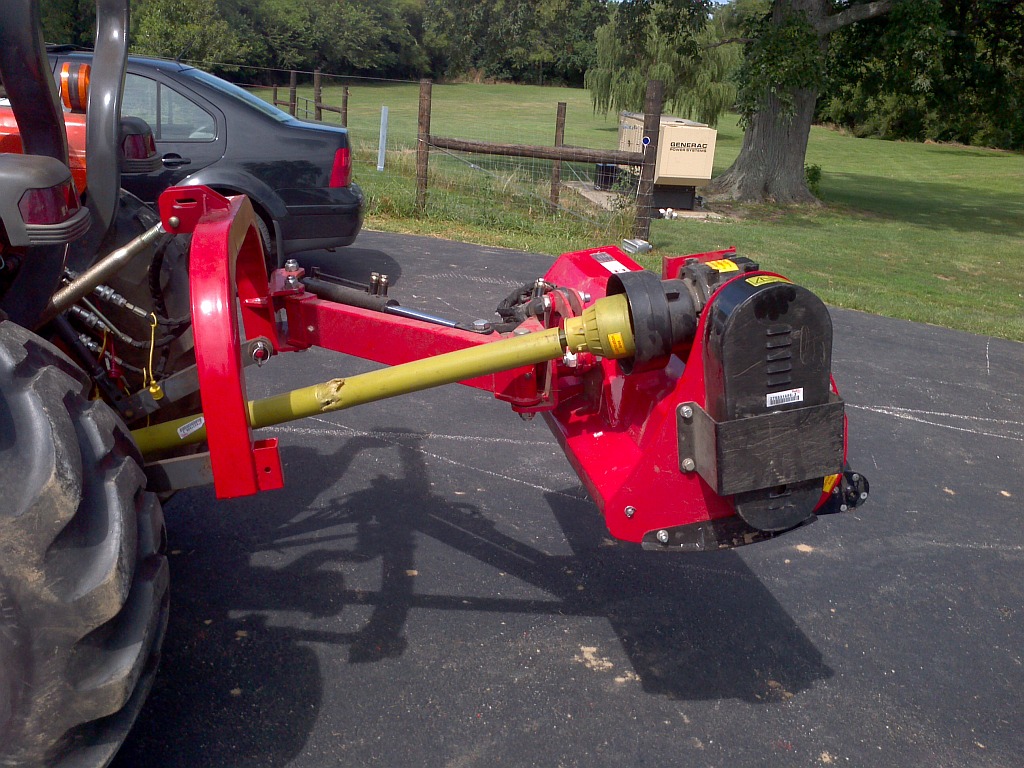

I just bought a verge /bank flail mower , the offset is great , the flail will the contour of the ground , thing works a treat along the creek and a couple,other places that I couldn't mow before...... Even the wife has taken to mowing banks etc .....
