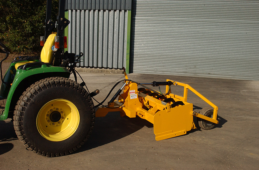

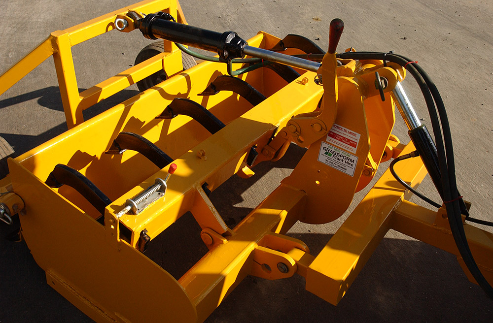

Travis, how about an option to convert the smaller ones into a drag scraper?
Notice the tongue pinned to the 3 point attaching pins, and the removable wheels.
Pictures from Google Image Search.

That's a very interesting setup.
Looks like you have about 90% of a pan scraper there. Just need to add the pan?

Yeah, I've been giving this some thought too. Especially after borrowing my neighbor's drag scraper. I was thinking about the wheels being farther back and hitching the front to the 3pt to gain more flexibility.
Xfaxman, did you build this??
