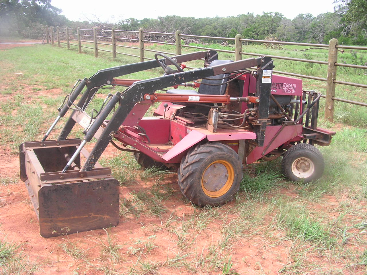

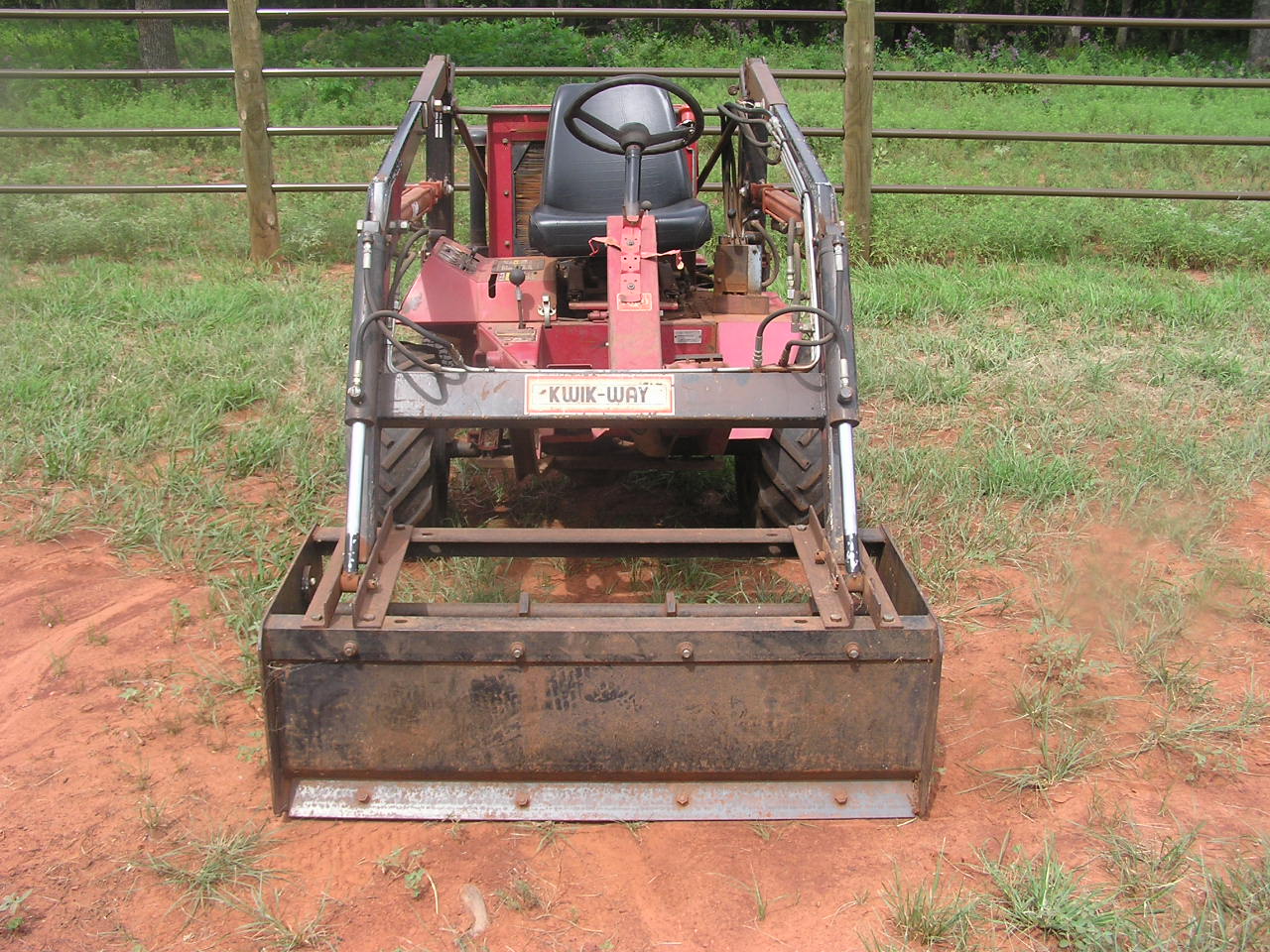

I'm not sure how it would act on your machine. Your geometry is kinda strange compared to a tractor.
Especially this one! :laughing:

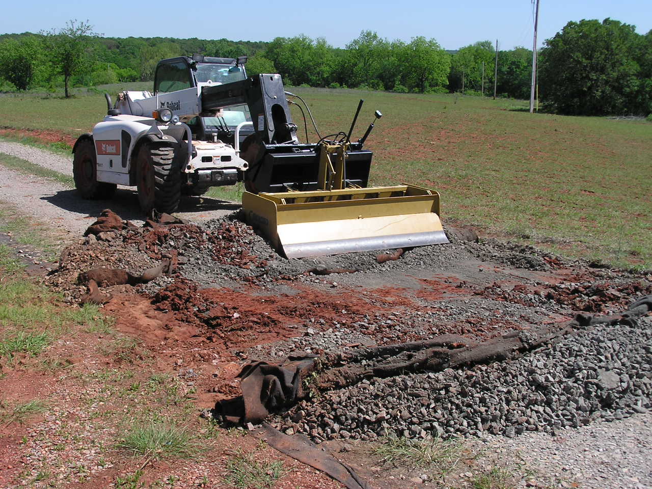

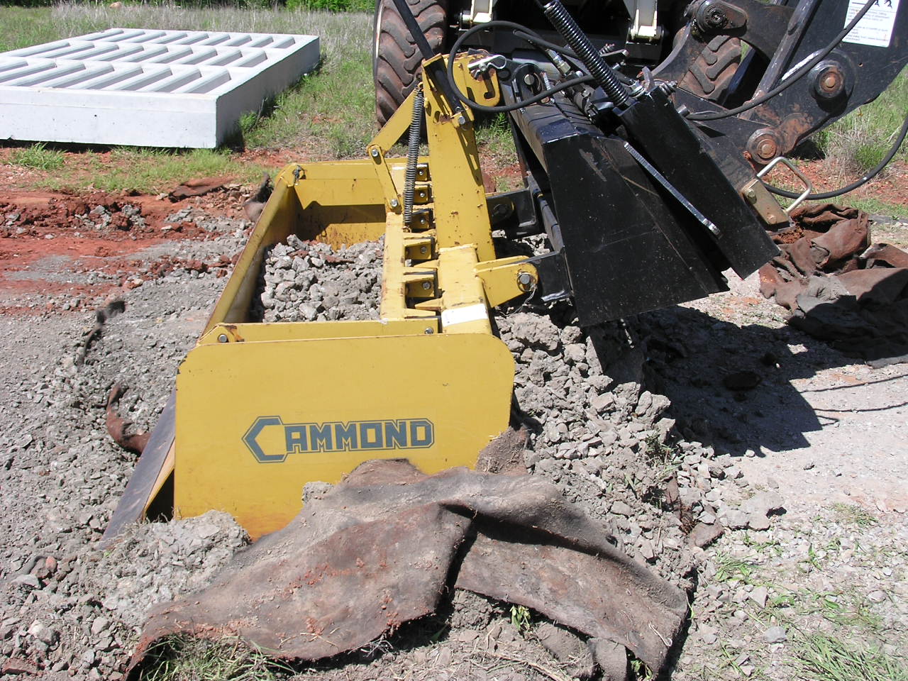

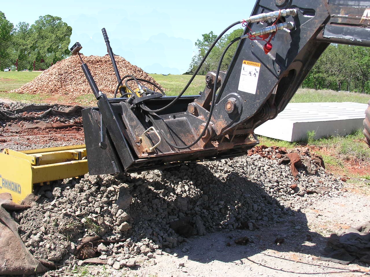

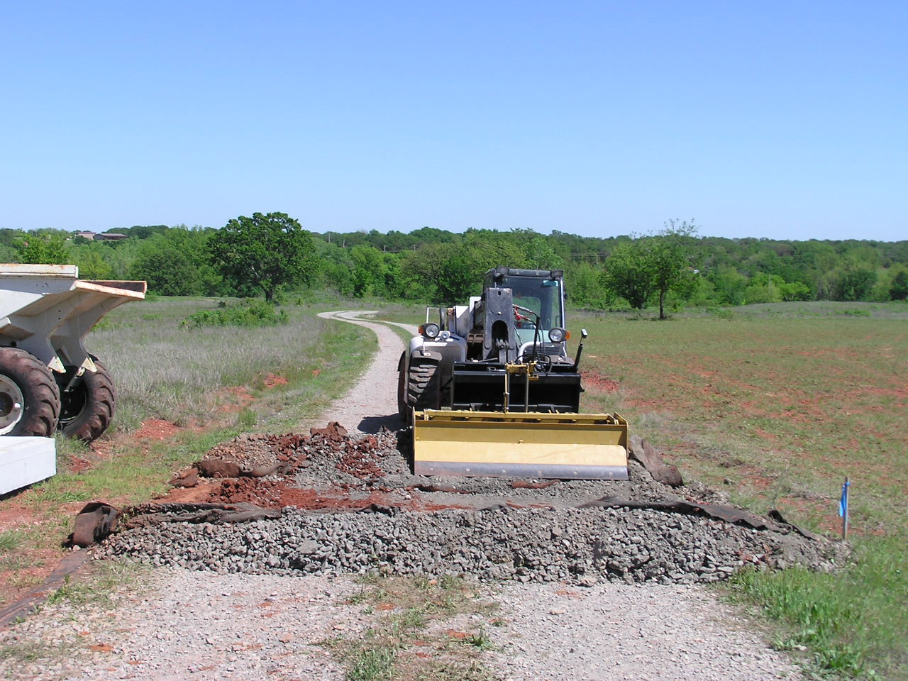

I usually put the loader arms in float and use curl to control the depth while backing up.
This machine has float on the boom, so it is the same operation.

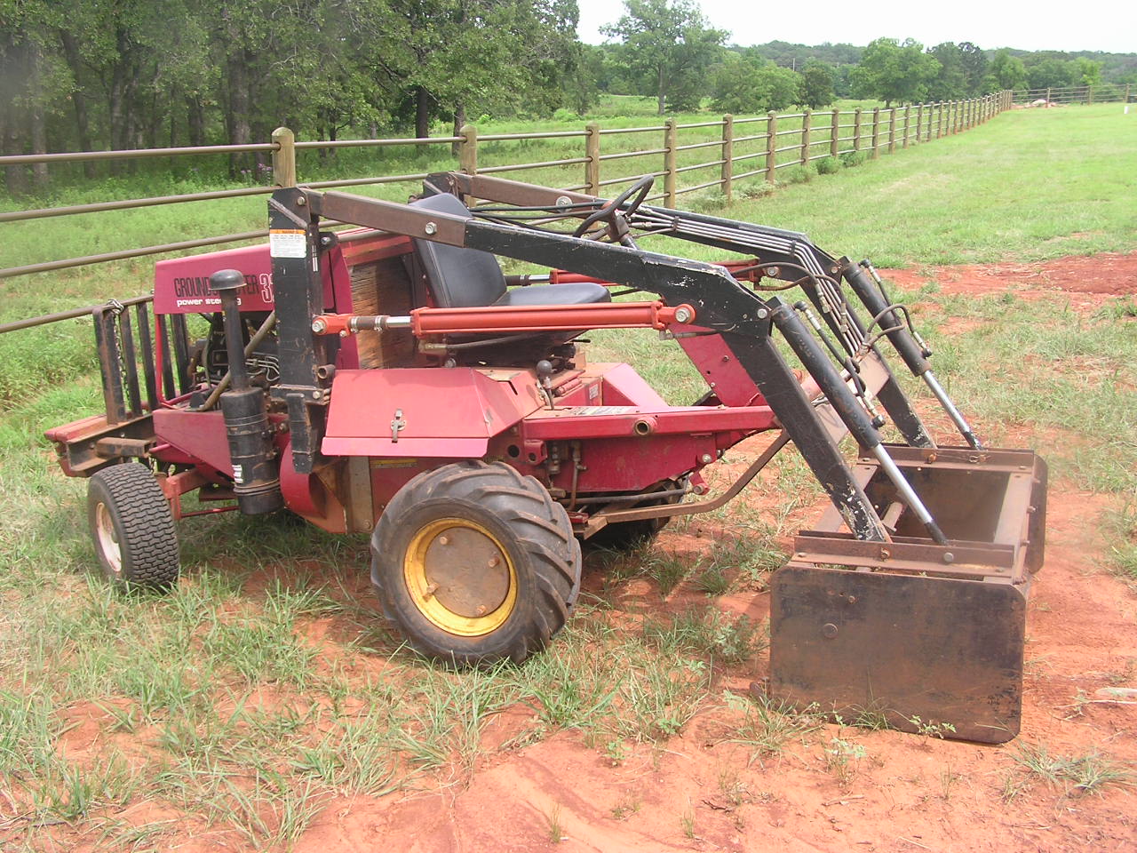

   / ATTN: Heavy BOX BLADE Experts.....Give us your opinions please. #180
Dennis, that Toro is one mean looking machine. Looks to be one of a kind and very versatile.
