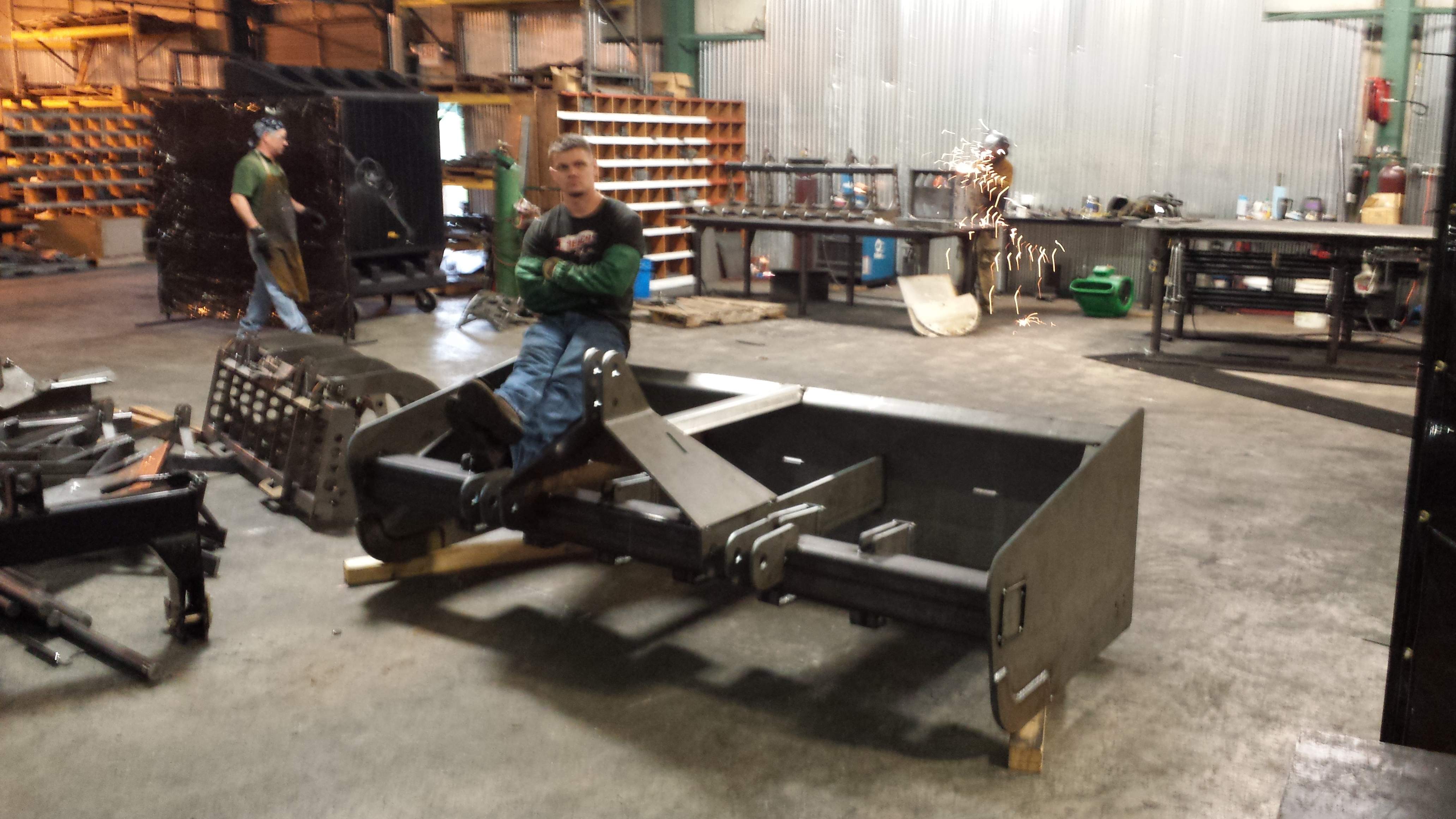

I really like the shank mount setup. I can understand where it is higher cost - material, process, labor - but it does seem to me like it would be a much better design than the common through the tube design you see everywhere.
How thick is the material on that unit again? That is a BIG BB, likely to be used on a big tractor with big HP doing big work.....3/4" - 1" sides?
The hitch and sides are 1/2" thick with an extra 1/2" plate welded on the bottom leading edge. The front 6x6 tube is 3/8". This box is designed for big tractors moving lots of material.
   / ATTN: Heavy BOX BLADE Experts.....Give us your opinions please.
#164
That last picture is definitely worthy of THE BEAST name, even if I still think a fifth grader came up with the name.
Yea, it's definitely worthy.
I think it makes the guy sitting on it look like a 5th grader.:laughing:
