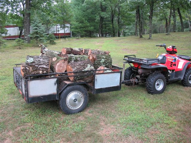

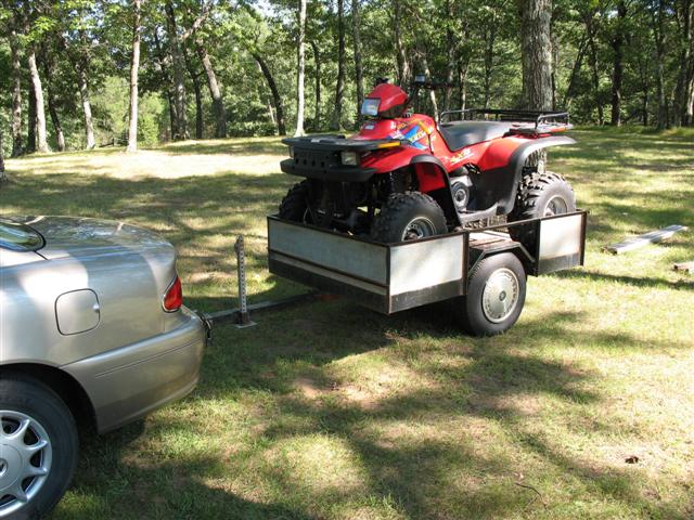

I made a couple trailers that are made to haul the ATV at interstate speed yet light enought to be towed by the ATV thru the woods.
Ultimately, that will be my goal. Big enough to haul the ATV, yet small enough to pull with the ATV. Best of both worlds.

The neatest atv trailer I have seen was build by a guy who hunts with me. He build it basically the same width as his atv with the deck over the tires. He can haul his atv on the trailer and pull it in the woods without it catching on trees.

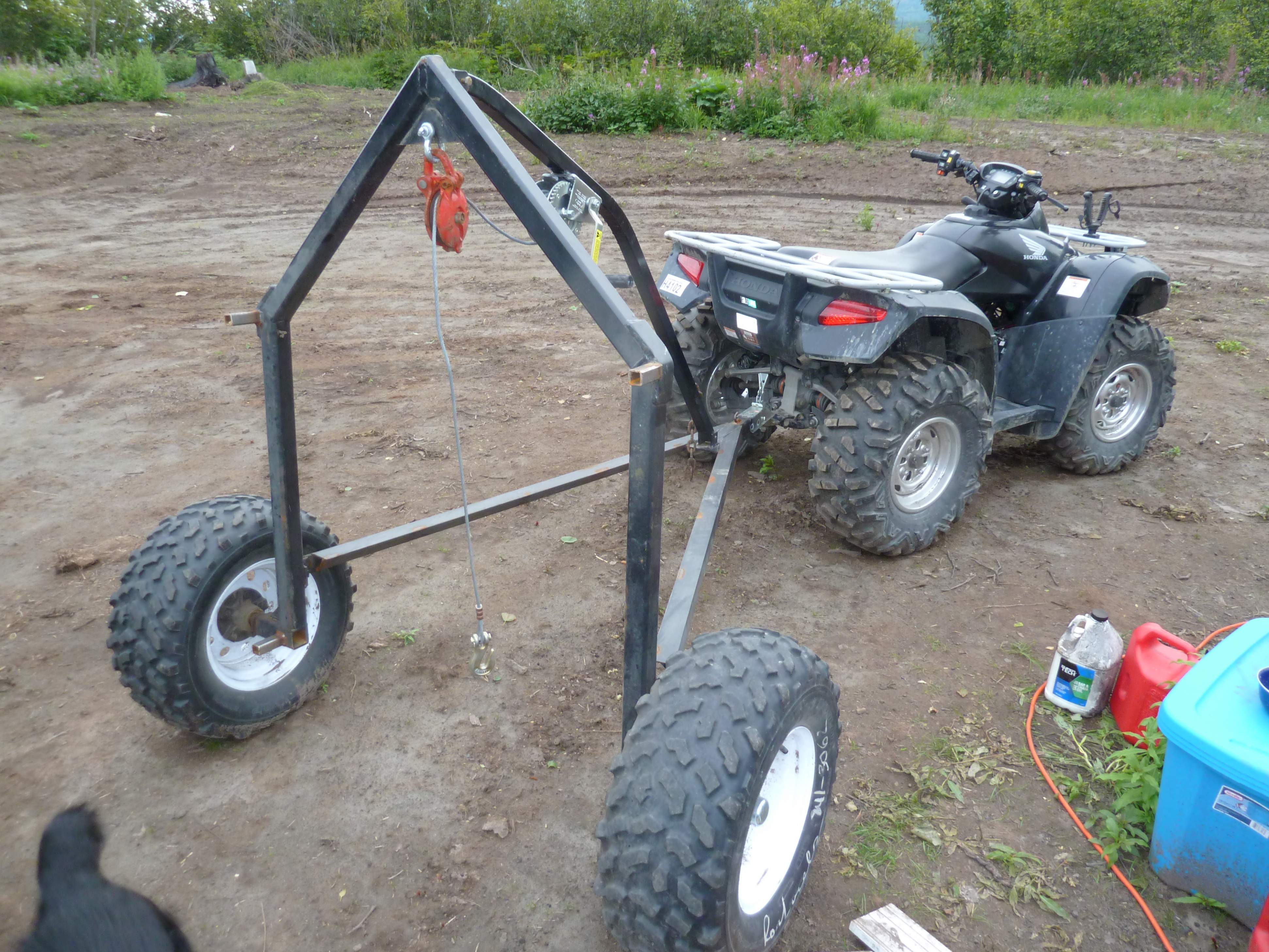

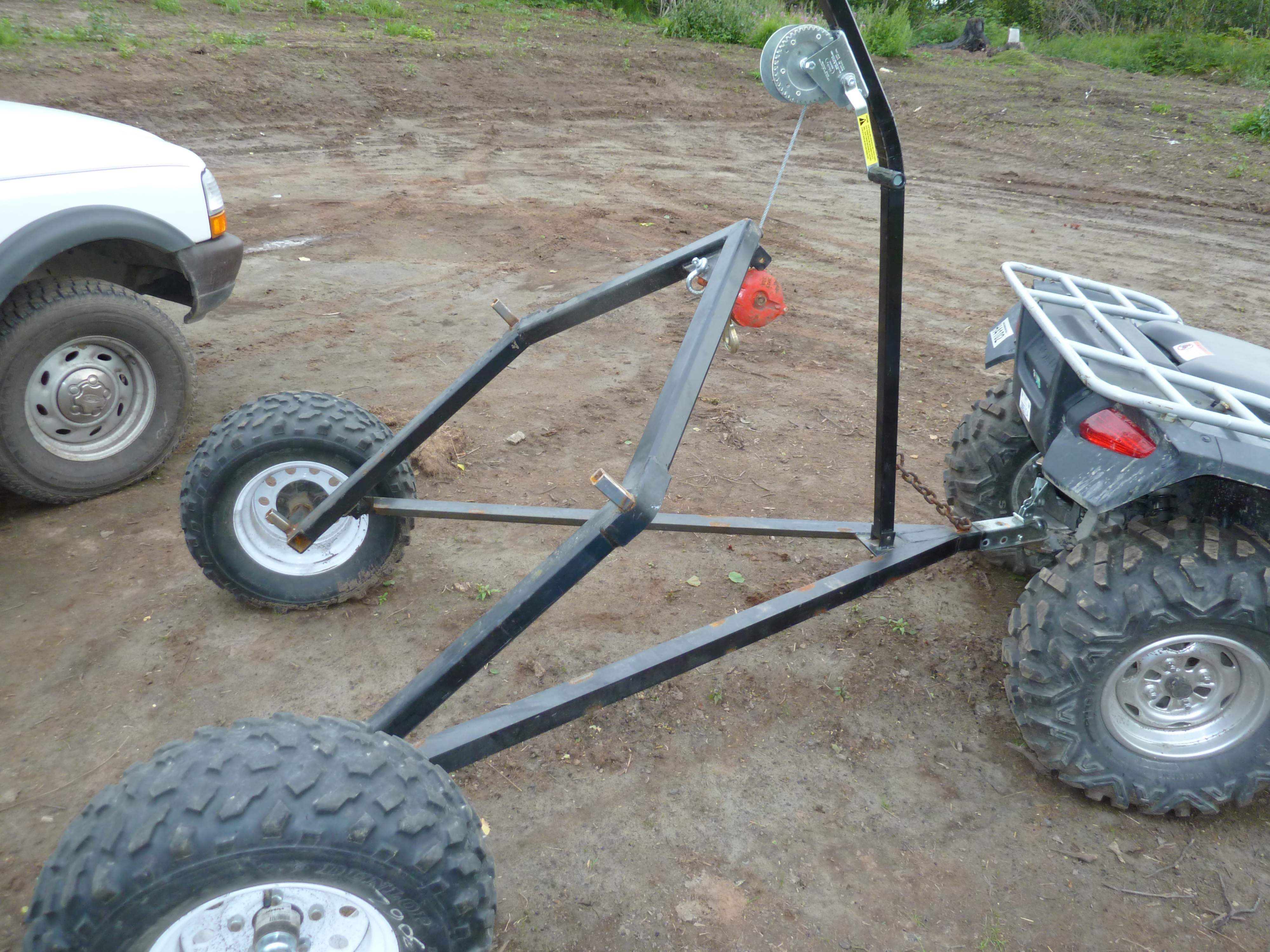

If you have the ability to build one this is what I did, works great. It is configured to use as an arch.
It folds down to create a flatbed with stake sides and works as a dump trailer. the bed just slides down over dowels and is easily lifted off the frame.

I really like that design as well. Any thing that is multifunctional wins in my book. Can you skid logs with it?
/ ATV Trailer #27
yes I use it to skid firewood logs. The winch is a boat winch and it will pick up all the quad can pull. and it will lift the bed with all you can put in it.
Without an axle all the way across you sure don't have to worry about being highcentered.
Wish I had a pic of the unit with the bed on. As it is you can see where the bed slips down onto the four square dowls. Is easily taken off and on.
