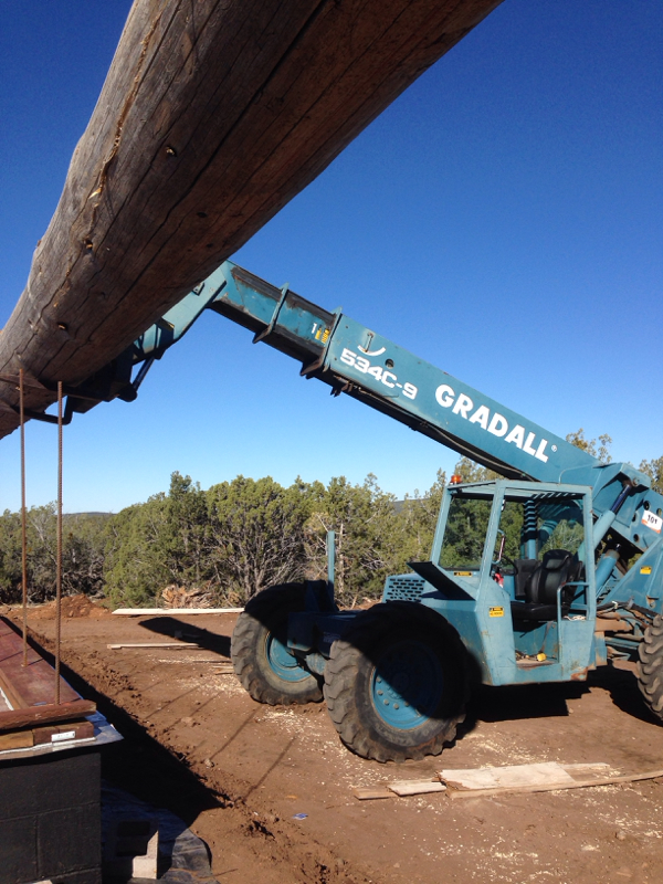

Here I am dragging the first log over to the foundation.
   / AZ ranch
#465
And here is the first log being lowered down. There are 13 pieces of rebar of varying lengths sticking up out of the foundation. It is quite a chore to get them all lined up as the log is slowly lowered.
   / AZ ranch
#466
Success!!! The first log is now in place!

I want the overdangle to be about 3 1/2 feet and that is almost 5 feet, so when I'm all done, I'll trim off a foot or so. :)
