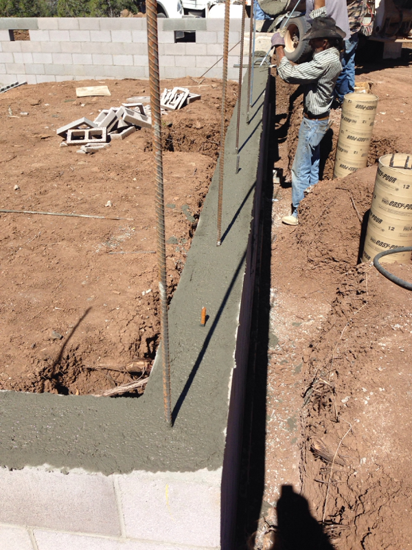

So now my walls are grouted (filled with concrete), it's time to replace some of the soil I had taken out of the crawl space. The backhoe guy went a little overboard and dug down to the bottom of the footers instead of the top. But now I have rebar sticking 4 feet up in the air every 30 inches, so it's a little difficult to get the backhoe bucket in there. My concrete guy says no problem, just bend over the rebar. I'm not too excited about bending my rebar, as every bend makes it weaker (IMHO).
Any experience with this out there?
I'm not sure I can picture where this 4' rebar is sticking out of or what is will be used for later? They do sell rebar bending tools, so it would seem that bending it once is not going to hurt anything and it's done all the time.
The rebar I have worked with was a soft steel, if you have to bend it and then straighten it, it doesn't seem like it would harden very much. I guess you could always test one. Bend it back and forth until it breaks.

The rebar sticking up is for what? Are you adding more courses of block.
Can you post pics from your phone?
Dave
   / AZ ranch
#424
I am building a log home and the first course of logs (about 32 inches in diameter) will have to slide down over this rebar (after I make a template and drill holes in the appropriate places).
