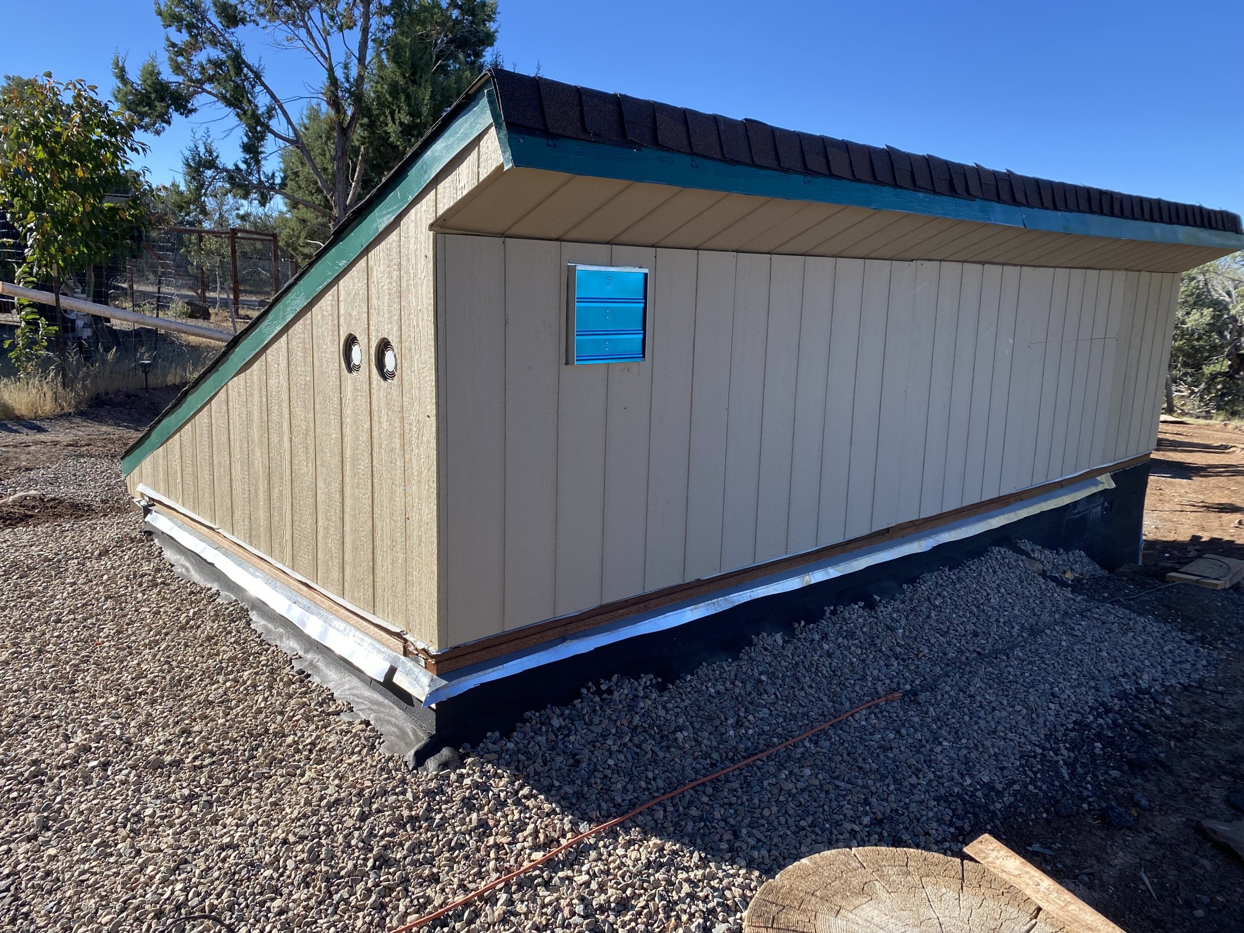

I finished almost all the outside. I have landscape fabric under the gravel. I like the exhaust fan, as it’s temperature controlled.
I started filling up one of the beds inside today.
   / AZ ranch
#1,479
Where did you purchase the fans?
Is the louver operated manually?
Building a similiar greenhouse, except it is only 3 feet below grade on two sides.
The 12 inch fan I got from HD. The louvers open automatically when the fan comes on. I need to make some smaller ones for the little fan. I don’t remember where I got it. It several years old and has a switch based on humidity while the big fan is set to temperature.
