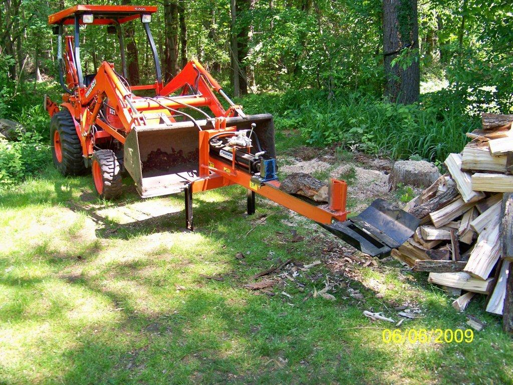

Agree with Jchonline, B2301 should be fine, as long as its in good shape and for most homeowner tractors would have 150-250 hours.
I have a 3PT splitter but use on the front end loader, and connect to the BH hose connection (6-7 GPM) as I use the BH to lift and cut about
30-40 rounds then turn around and split. But for the cost of the 3PT vs a dedicated splitter I would go dedicated with engine, as they can go vertical too.
