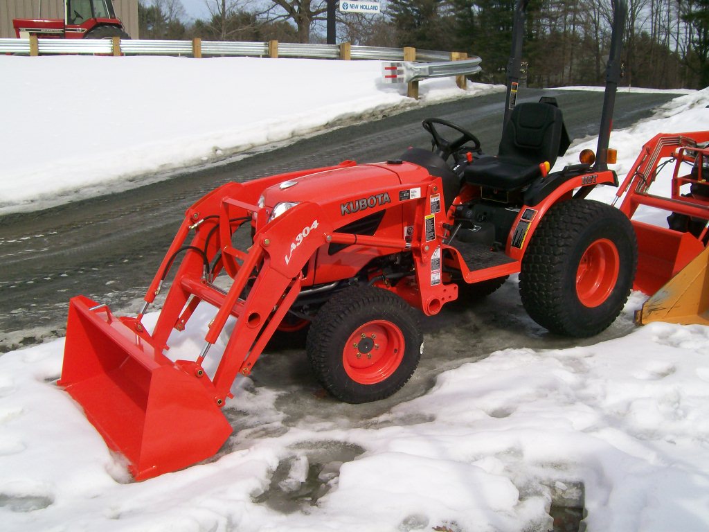

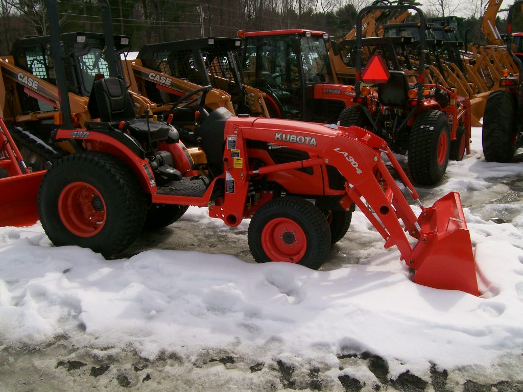

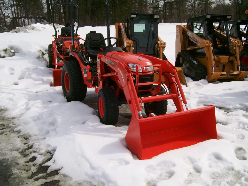

Elsie, here is what a B2320 looks like with turfs.. and a closeup of the new seat for those that asked...

Saw the 2320 today with turfs, already with a prominent sold label on it. sure has a small bucket, whats the largest width that can go on the 2920?
   / B2320, B2620, and B2920 #196
Only 1 bucket option on the 2620/2920's LA364 loader - 50". And when I put a tape measure to it, it was only 49". The BX has a 48" bucket.
