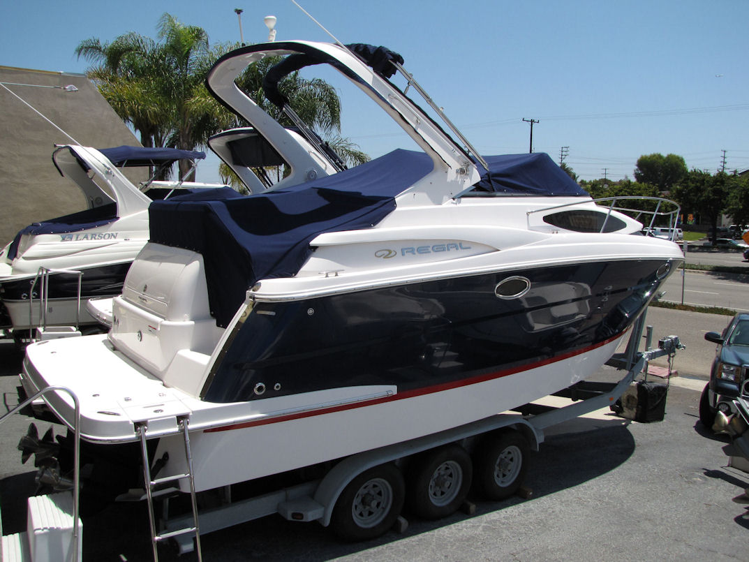

Heres a pic of the boat I'm moving around.
/ B26 - Pull Boat/Trailer? #20
Whew, that's a heavy looking boat. No wonder you're asking the question.
It'd pucker me up pretty good the first time, but I think you'll be OK. Slow and low. And with the triple axles, not through too sharp of a turn, me thinks.
