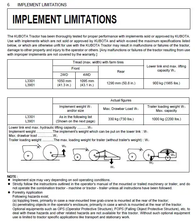

I doubt his drawbar is rated for more than 500# tongue weight, not sure why everyone always goes to draw bar they are made to pull wagons or implements with almost no tongue weight not to hold it. I understand the risks of the 3pt and it's also get draw backs but it's not going to break/bend under load like the drawbar will.
And what do you mean you wouldn't pull through a frame? A direct pull through he frame is about as harmless as you can get on a tow, next is probably off the axles.
ETA can't find the equivalent specs on the mahindra but this is Kubota's for slightly larger tractor, 730# tongue weight 2200# max trailer weight on the drawbar.
