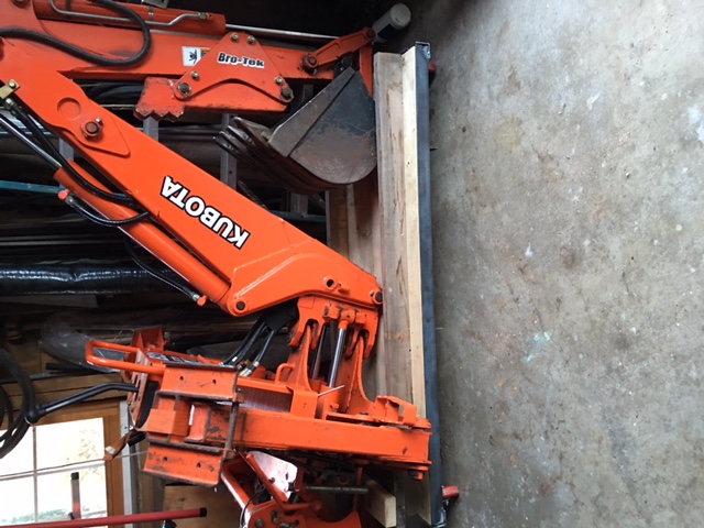

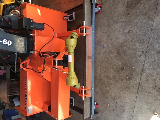

I use the 3PT - 6' landscape rake, 6' Rear Blade (for grading and snow) and 5' Rear Snow blower. No need to worry about how strong it is - it will handle it. From a realistic user experience, I leave the BH on April to November and use the bucket to grade loam and stone, unless I have a big job needing the landscape rake or back blade I will change out the BH for a 3 PT implement. When you get good with the B26 you can grade and level spots in a driveway easily. Now, would I do a half or 1/4 mile with the loader no, I would swap out and use a box or rear blade.
Now many others on TBN use the 3Pt with Top and Tilt or 3 PT trenchers to make trenches and pipe ways, and FEL spades to plant trees, and they work.
If you are anticipating a lot of change out of 3PT then get the Harbor Freight (or similar) 3PT Quick Hitch $99 that allows you to back up and connect to the device quickly - of course after the BH is off. The BH takes 5 min to remove and I built a dolly that allows the SB or BH to be rolled right up and attached/detached quickly.
Regarding the "strength" of the machine, all the components of the Kubota TLB series are "upsized" if you look at the axles, the frame and then as Gary states the underbelly is totally protected. This is not the case with BH added to tractors. When I was buying comparable machine (for lift and digging) was the Kubota L3130 and it still lacked the undercarriage protection that I wanted and didn't meet have the digging specs of the B21.
