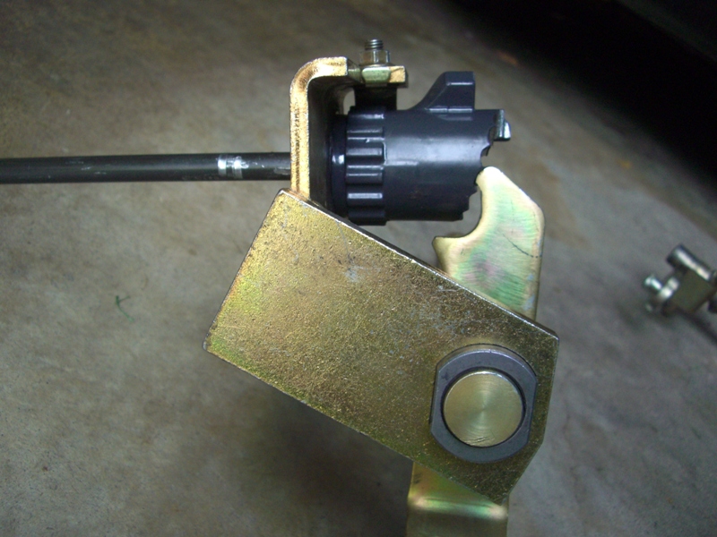

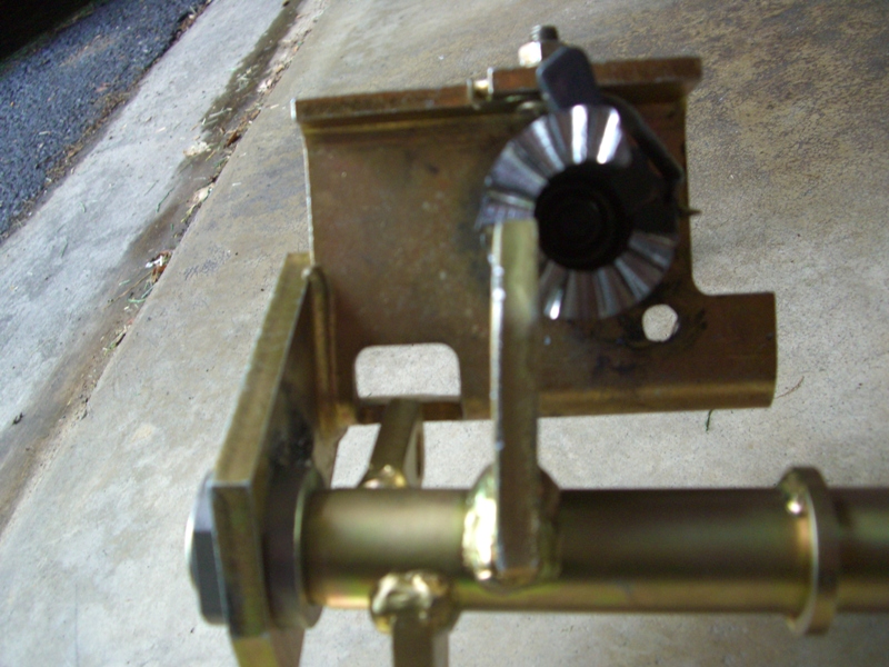

I finally took the assembly that holds the MMM at the proper height to the dealer. They will install a new spiral cylinder with enhanced (grinded) notches. They are also straightening out the lever that engages on the notches so that it engages at the outer edge of the spiral cylinder. Basically bending it out. The shaft did not have any side-play as others has reported, so they had to bend it.
The main problem was that the lever was engaging too close to the center of the cylinder and at that point, the notched are not that deep.
I know this description is kind of cryptic. I'll post a picture of the assembly when I get it back (this Wednesday) and post the results.

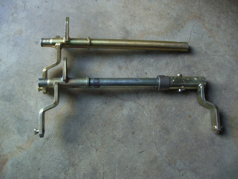

I got the parts back today. Here what they did:
1) New parts - the stepped cylinder and the shaft
2) Grinded down the steps in the cylinder to enhance the steps
3) Straighten the lever that engages on the step to align it
4) Grinded the top of the stepped cylinder so that the knob is not wobbly
It looks like it is going to work better with this improvements. We'll see when I mount the assembly on the tractor and put the MMM back. Attached are some pictures of the new and old shaft and of the wohle assembly.
I will report back how it all works.

Hi, I have the same problem when I mow over an uneven lawn (river bank and field) the dial bounces out of adjustment to the point that the cam surface worn smooth. What I did to fix the problem was have the dealer replace the cam and order a second cam spring (Kubota calls it a plate retainer) and I installed two springs together. (old selectric typewritter repair trick) along with a plastic washer I cut from a coffee can lid to fit between the cam and the cam base, This removed all play from the shaft and by adjusting the cam nut until the knob was allmost too tight to turn, has fixed this so far... PS don't try to bend the cam spring, I will snap before it bends. :eek:
