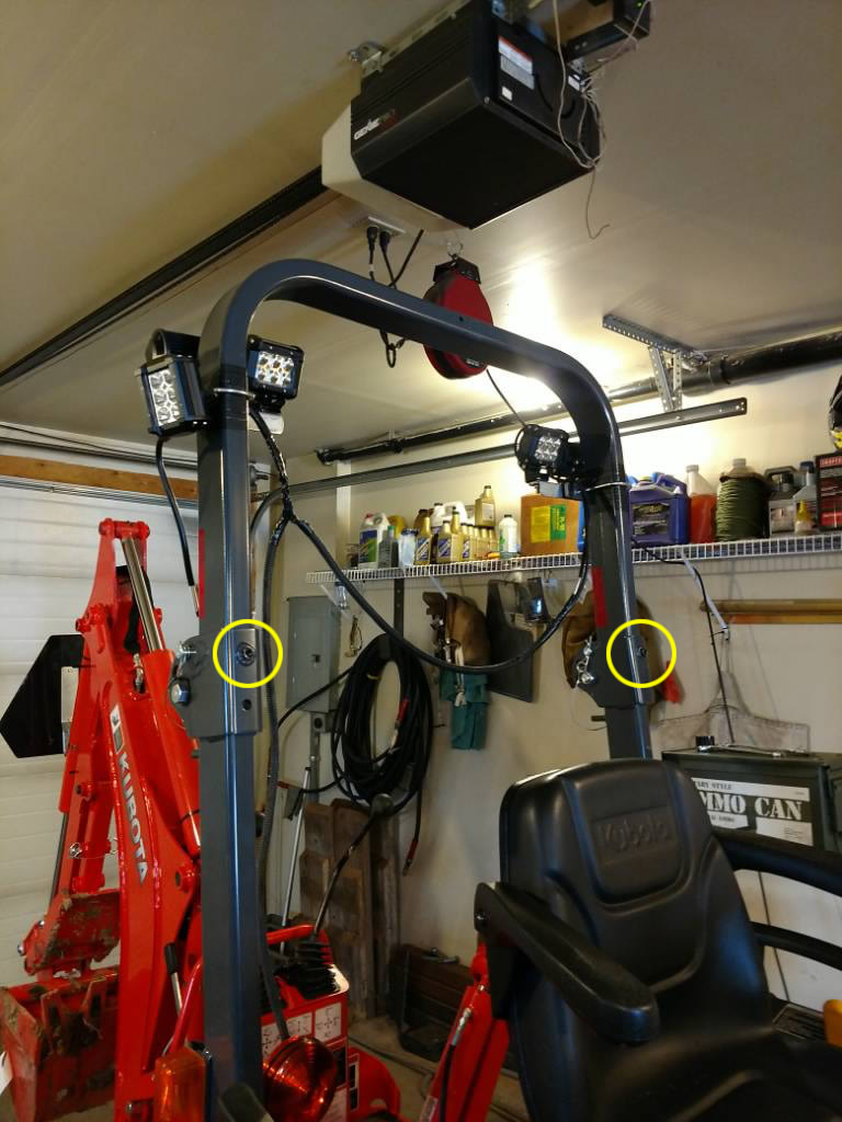

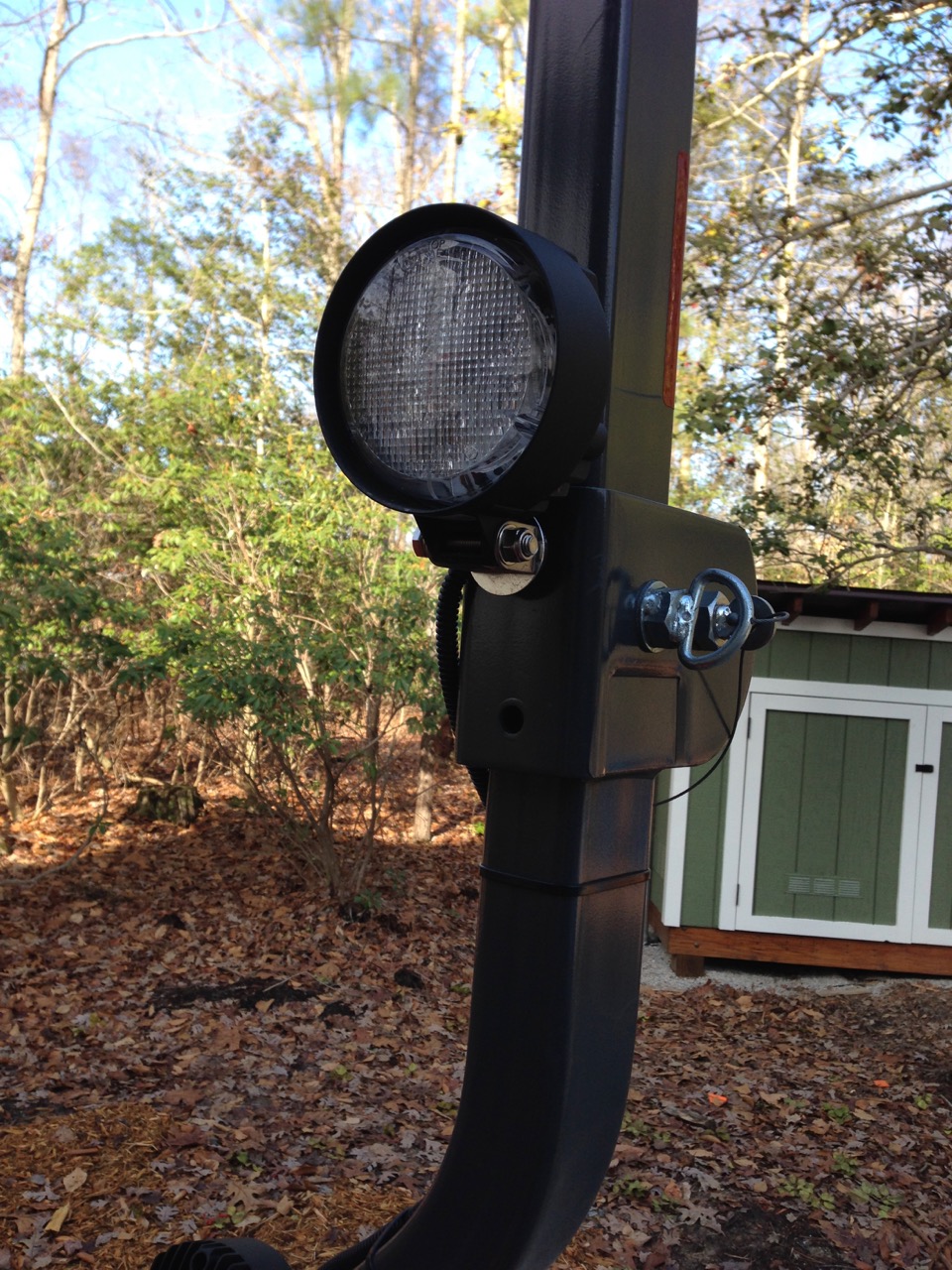

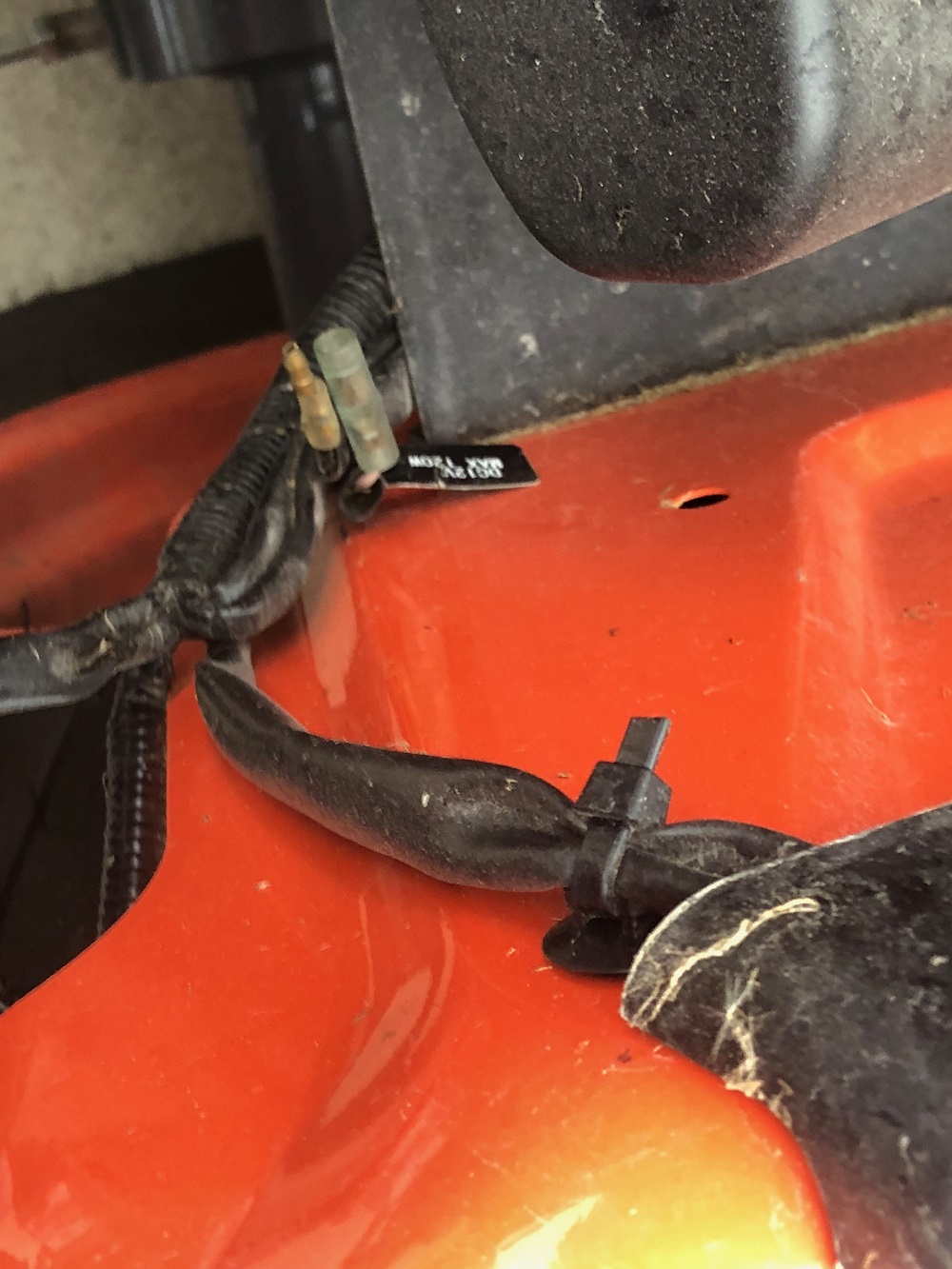

The easiest will be to tie into the work light circuit, which runs a wire to one of the rear fenders already (normally the left). Tie into that and then add a switch (or switches) at the rear of the tractor.
As far as mounting, I am amazed more people don't use the threaded mounts already on the ROPS, circled in yellow below:
It's a good fixed rigid mount that doesn't get affected when you fold the ROPS and you don't have to dick around with clamps, etc or clutter up the ROPS. I forget the thread size, but it's a standard metric thread (M10 maybe?).

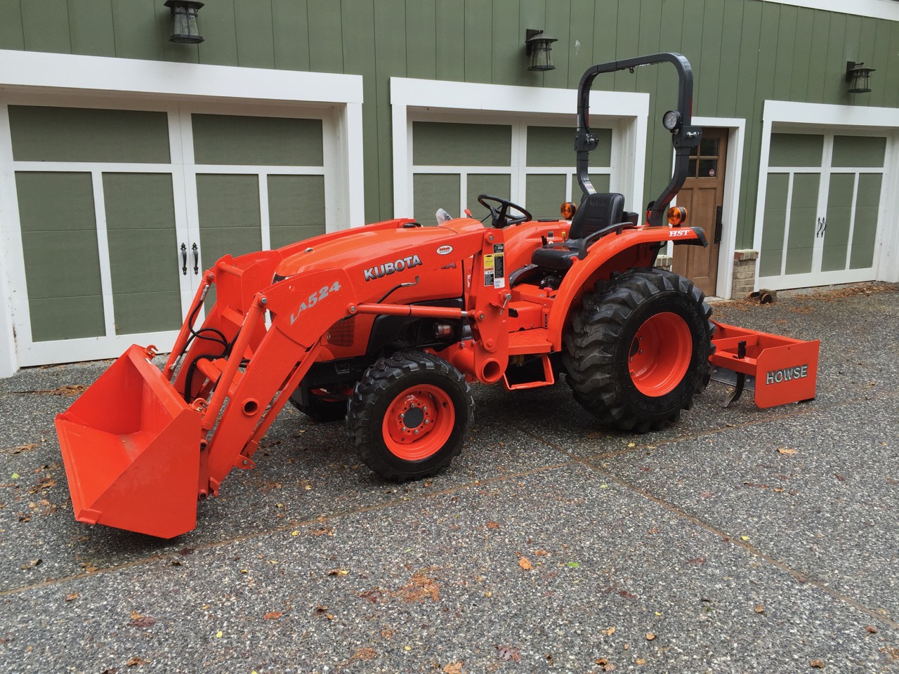

s219 -- don't know about you but I don't want the lights shining into the back of my head. Or right in my face if I turn around. Need them much higher.
Rob80 -- take a look at the pictures I posted earlier in this thread. You can see where I installed a switch. On my tractor there was a rubber grommet there. No cutting, just pulled out the grommet and dropped the switch in.
Hasn't been an issue on my Kubotas -- I mount the lights there on all of them. But I can see how it might be a problem on a smaller tractor like a BX though, as the ROPS is a lot shorter and narrower on those.
That's a great feature and good to find out that the threaded mounting hole exists. It does not exist on many models, especially older ones, however.
