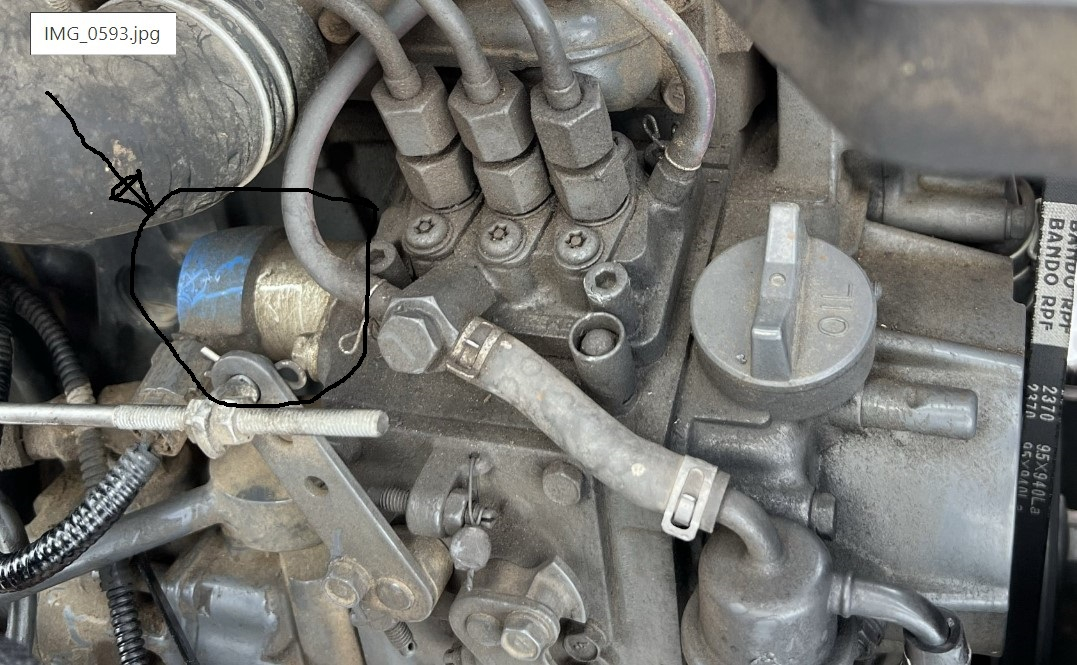

Anything is possible but it seems awfully unlikely that some complicated mechanism or gizmo failed right in the middle of his working and running the tractor. Seems more likely to me that the fuel gelled (and the sputtering partial restarts are typical of that problem.) I'm thinking various other issues were fallout from taking the fuel plumbing apart.
I have a friend with a Bx23 that had his quit one day. He ran the tractor shut it off and wouldn't start the next time. It was the fuel shutoff that went bad that fast. Electrical components can go at any time doesn't have to be a slow process. Diesels run on fuel and compression. Electric is only needed to work the starter. No fuel no running, that's why a simple air leak stops diesels from running. The fuel shutoff is nothing but an electro magnet that pulls a pin out of the way to let fuel pass through. It's like turning the fuel off with a valve. Easy way to check is unhook it and turn the key to on and see if it pulls the pin in. If it does it's ok.

I would beleive so but to be sure as was suggested just remove the fuel shut off solenoid, it is only 2 bolts. However, if your tractor starts with it removed you'll either have to reinstall the shut off or block off the air to the engine as your tractor will not shut off.

You mean that little hose you took off when you did the video? NO! That is only showing your lift pump works. The solenoid shuts off of fuel in the injector pump. I'm thinking there is so much air throughout the fuel system that it needs a knowledgeable person to troubleshoot and bleed it at this point.

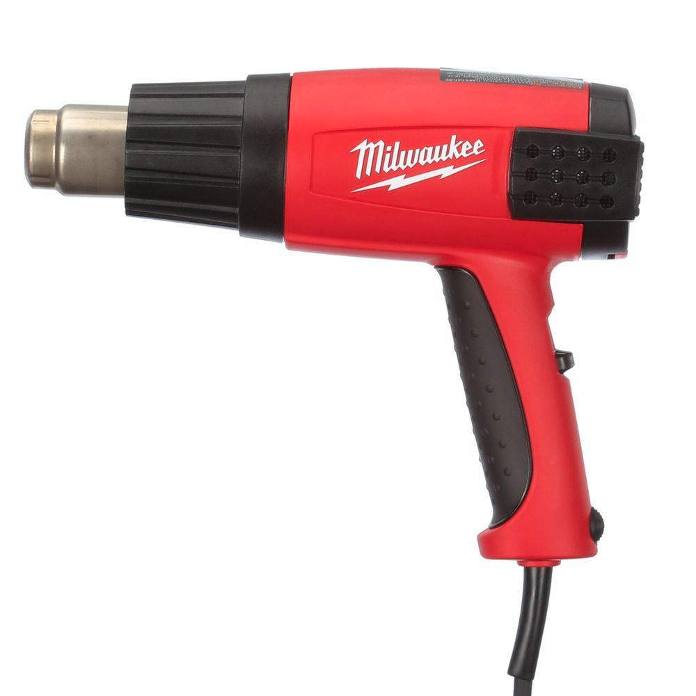

All good, except a "hair drier" won't be hot enough outside. A heat gun might.
