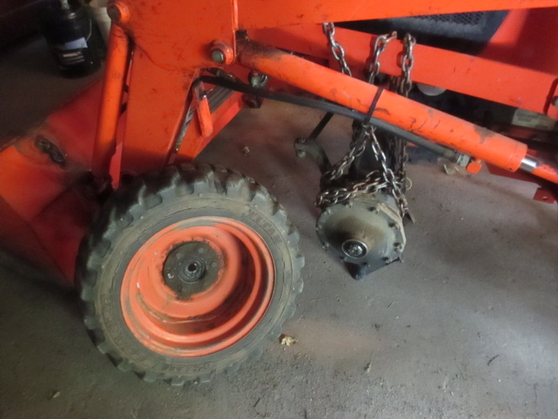

Well in 10 days it will be 3 years since I broke off the RF wheel. Today, I broke off the LF wheel :) Thankfully, I detailed my experience here, because I had completely forgotten what I did to repair the other one. It happened not far from where I broke the first one, way down in the woods. I remembered a suggestion here to lift the axle off the ground with the bucket and chain it to the frame and 3-wheel it out. It worked like a charm! I was back at my garage in 10 minutes.
So, tomorrow, I will take it apart, bring it to the dealer, have them order the needed parts, including new studs, Have them press out the old bearings,etc, install the new ones when the parts arrive, pick it up and re install it .
Let's see if it goes as planned :)

I know what you mean. I brought the bevel gear and case to the dealer to get the parts put in and got to see all of those new shiny Kubotas !!!!!!
I really have no complaints on my B2910, I have asked it to do much more that it is rated for and those axle breaks are the only problem I have had. It now has 1200 hours on it and I hope I can keep it going for another 1000 w/out too much trouble.
I put the axle assembly back on last night and let the RTV gasket maker set up. I'll put the 80w90 oil in today. I am also going to do the 1200 hour maintenance as well and hopefully, be back in business ( is there a fingers-crossed smiley? :) )
