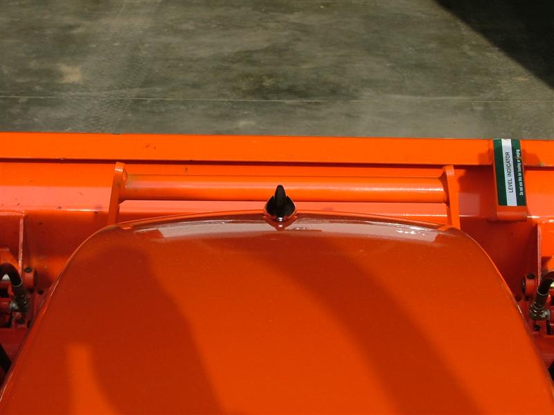

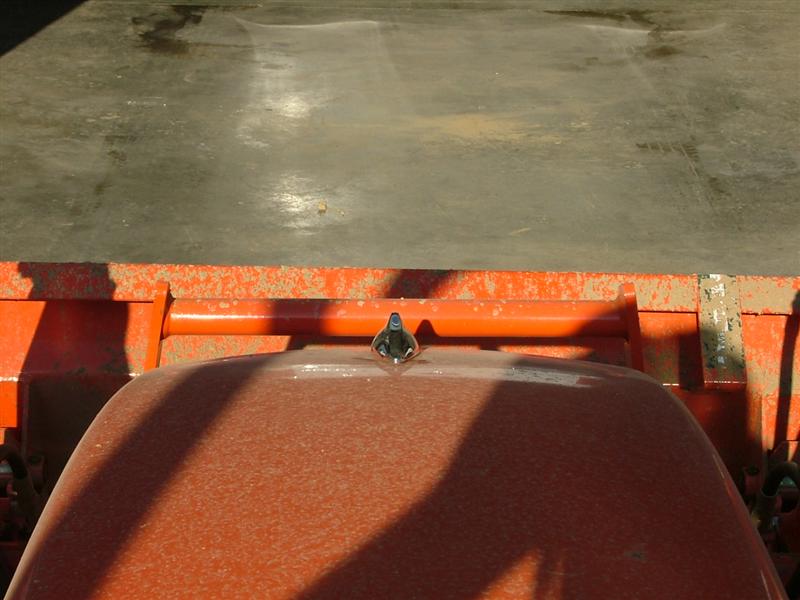

Tube after.....

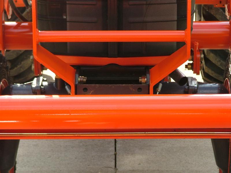

#82
bucket top against grill before......

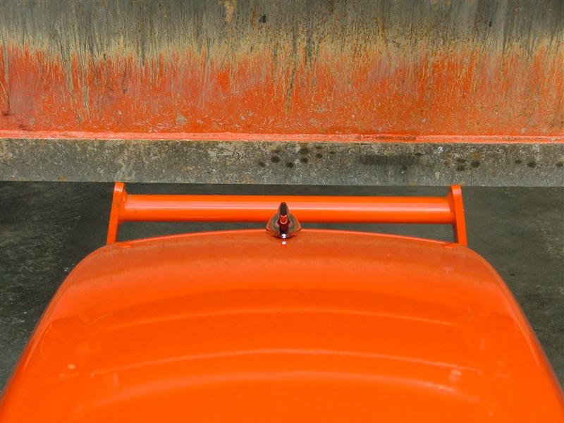

   / B3030 LA403 loader still crooked....
#83

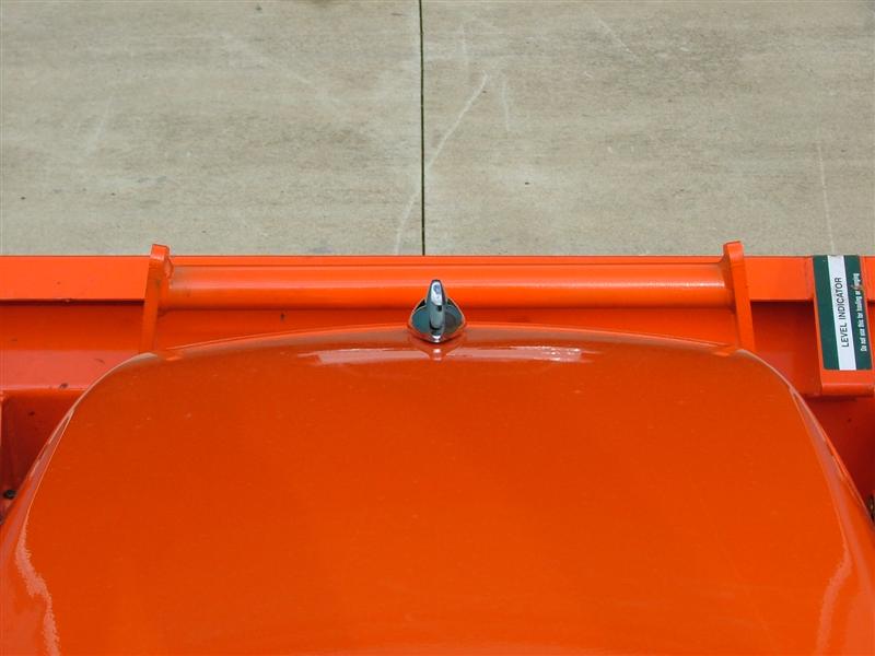

and after.... I am liking what I see.

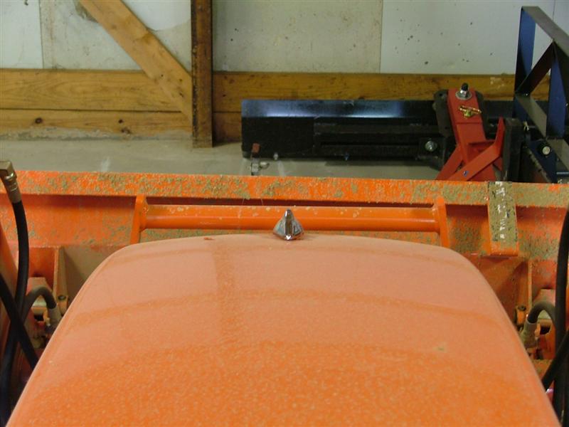

#84
Bucket lip before.....

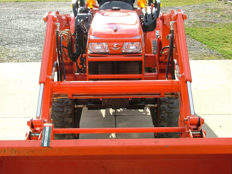

#85
And the bucket lip after......

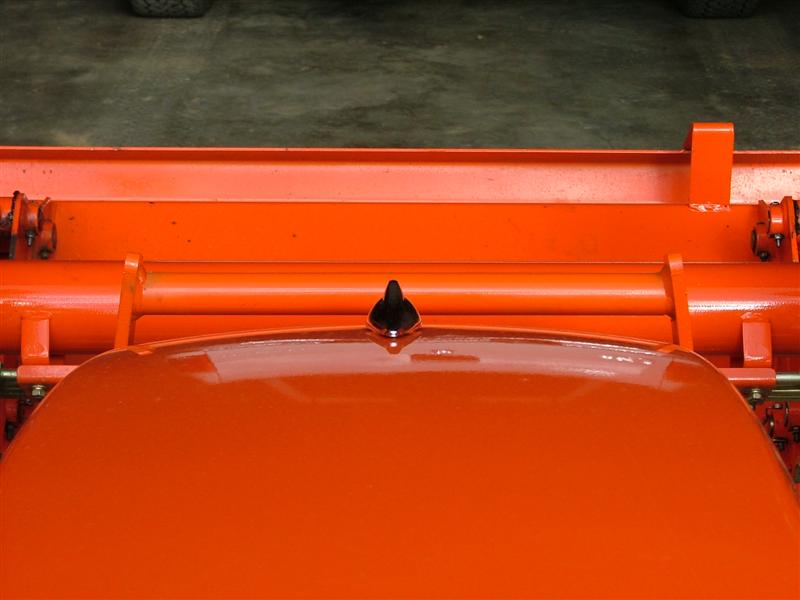

#86
This is just a reference to where my cutting edge is with the top of the grill guard after the fix.
#87
The main cross tube looks pretty level with the grill guard tube now. The grill guard on mine is perfectly level...I checked it many times. /forums/images/graemlins/grin.gif
#88
This last photo shows the main loader cross tube in reference to the frame. If you eyeball the two holes in the frame with the tube you can see it is much better than before.
I hope this helps those who are searching for a fix. Now that I look at these photos I think the fix worked out better than I originally posted. I am happy with it. /forums/images/graemlins/smile.gif
   / B3030 LA403 loader still crooked.... #89
I'd say they got that thing fixed. It looks a ton better than it did!
   / B3030 LA403 loader still crooked.... #90
<font color="blue"> He said Kubota has admitted there was a fixture problem with the uprights. </font>
It's good to hear that. I know that it has been quite a problem for some owners. It is rare that someone in his position will tell a customer what the problem actually is caused from. Now they should be able to get the rest of the bad frames taken care of.
