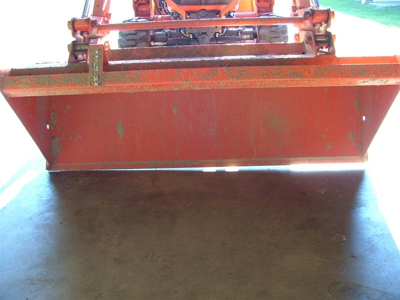

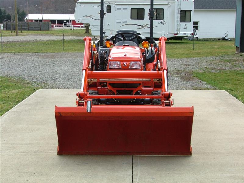

Ok here are some before and after pictures of the loader.
I must say just by looking at the difference it was worth the effort to get it fixed.
Here is a before on my garage floor.

After same garage floor.

As said before we notice the offset with the brush guard which mounts on the frame. My rep called me today after work. He said Kubota has admitted there was a fixture problem with the uprights. My rep sounds like he's really going to work with me on this problem. He was willing to get one out of the warehouse and have it measured before shipment. If the Loader still remains out less than 1/4" with brush guard not floor I would feel this was acceptable tolarance.Rep did say the manufacturing plant somewhere down south was aware of this topic being disscussed on TBN. I'm glad to see them reading this site. Great tool for them. I'll keep you all posted on the progress. /forums/images/graemlins/smile.gif

Concrete pad before.

Pad after....I see a big difference /forums/images/graemlins/smile.gif

Main tube before....
