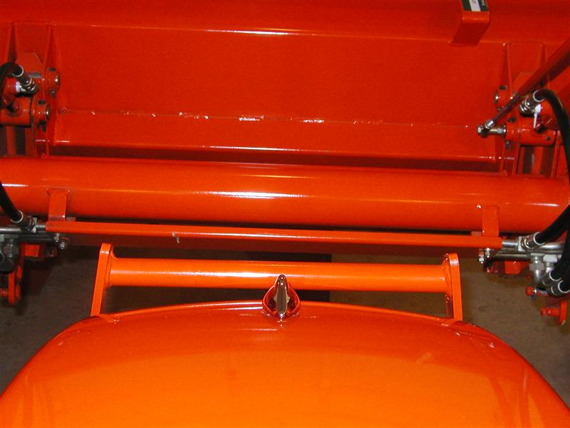

jlbota yours looks better than mine. Heres a picture I took tonight.

Looks to be off as much as mine was....You gotta get that thing fixed so you can get some dirt on it. /forums/images/graemlins/grin.gif
   / B3030 LA403 loader still crooked.... #93
Kubota rep came by tonight to look at the loader. We made many measurements. He is going to get a new left upright ordered. He was very helpfull and wants to get this problem resolved.We found a second issue with the left upright.I'll have to get a picture posted because i'll just get you confused if I try to explain it.

The right one on mine fixed the problem...They changed the left side first and it didn't seem to make a difference.
Maybe yours is different?
I am glad someone is helping you out though.
Let me know how it goes. /forums/images/graemlins/smile.gif
I think I get your meaning now about the left upright...You found a problem with it in addition to the right one? Is that right?
