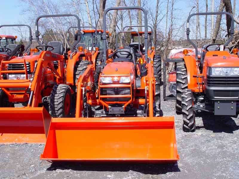

Last time I went to my dealer I took some pics of my B3030 but it wasn't ready yet. The BH75 wasn't mounted neither the belly mower. It should be home next week... around monday.
I saw too the plastic cover on the right fender. I think this is cool to have the possibility to install factory auxiliary valves integrated into the right fender. The problem is the price of these valves.
I don't understand why they've put the cup holder behind the seat. /forums/images/graemlins/confused.gif I'll have to install an other one.
I'll post some pics I took that confirmed your observations. As you can see on this pic, I couldn't have compared it with other B series because on the left is a... L3430 (or so) and to the right a... L3400 (I think).
Is your B3030 ordered?
Thanks again... /forums/images/graemlins/smile.gif

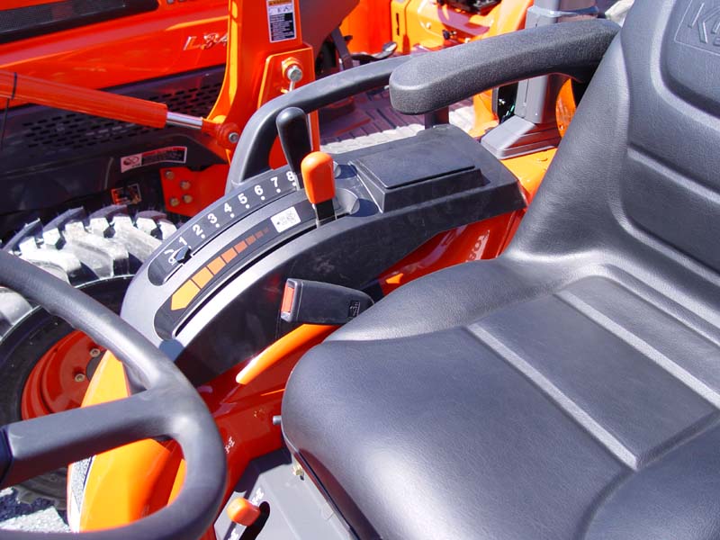

This one is about the trap for the valves and the cruise control.

   / B3030 observations #4
This one is... the left fender.

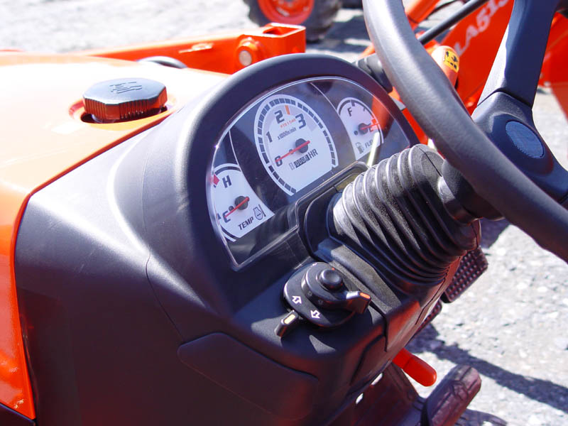

   / B3030 observations #5
I like the new dash. Ouhh... 24 minutes on the clock counter.

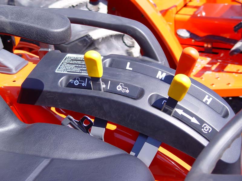

   / B3030 observations #6

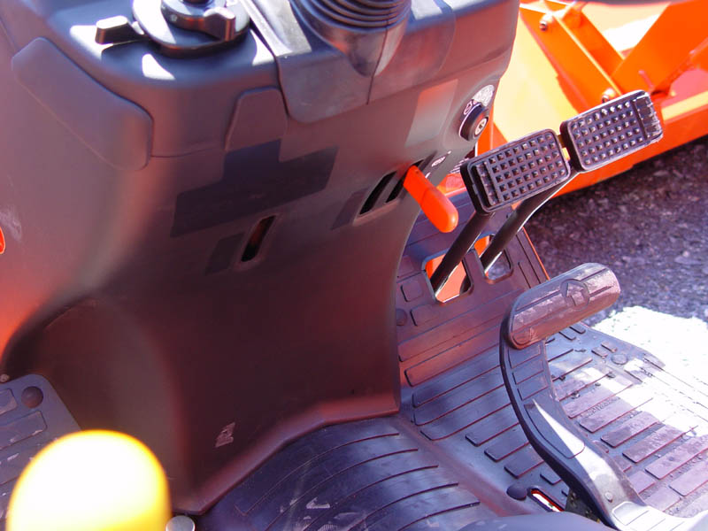

On this one: the metal pedal (bottom left).
Ron I have a question. How many levers below the dash have you seen on the B3030 you looked at? Because on my pic there's only one for the parking brakes. But when I look at the B3030 brochure, the pic of the B3030 interior (cab model) has two lever like a B2910. /forums/images/graemlins/confused.gif I asked my dealer but he doesn't know the answer.

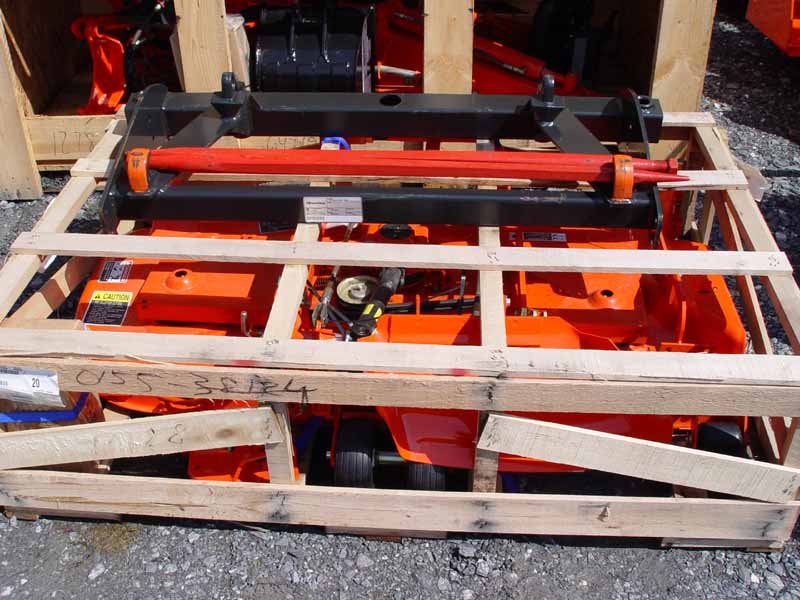

   / B3030 observations #7
As I said, my B3030 wasn't ready when I took the pictures so that's why my mower was in a crate.

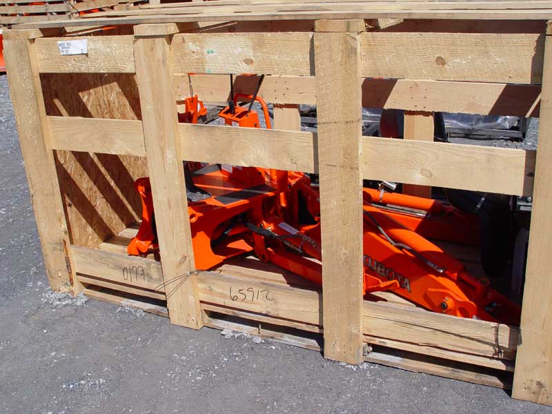

   / B3030 observations #8
The same for the BH75. /forums/images/graemlins/confused.gif

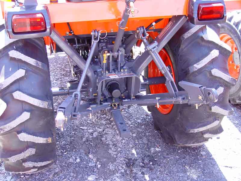

   / B3030 observations #9
I don't know why I took a pic of the hitch but there it is.
