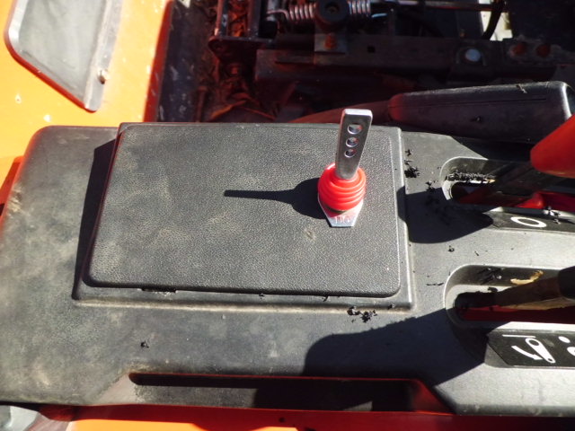

I ran the power and ground straight from the battery. I put the wire in conduit and placed two rocker switches on a plate mounted under the seat. I used the cover plate of a plastic outdoor electrical box for the plate. I would take some pictures but the tractor is at the cottage. Don't forget an inline fuse.

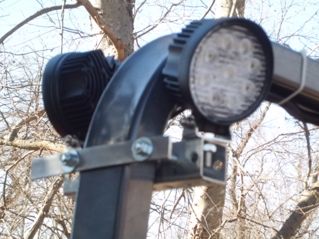

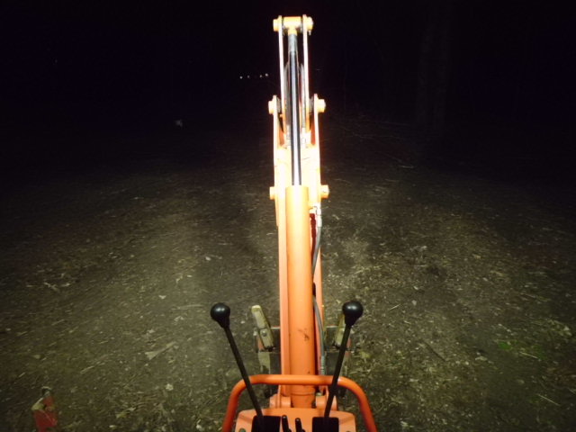

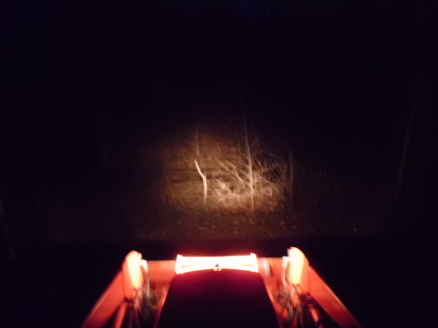

......------ update------.......
holy s#$% these things are awsome!!!!!!, i just finished as much as i could do tonight and took it for a test drive, my daughter said i look like the sun driving through the back yard. The light is amazing, i have been a big fan on hand held LED lights for a long time and this little 100.00 upgrade means i can work way into the night if i want.
I will post pics and material list for future kubota guys in the dark.

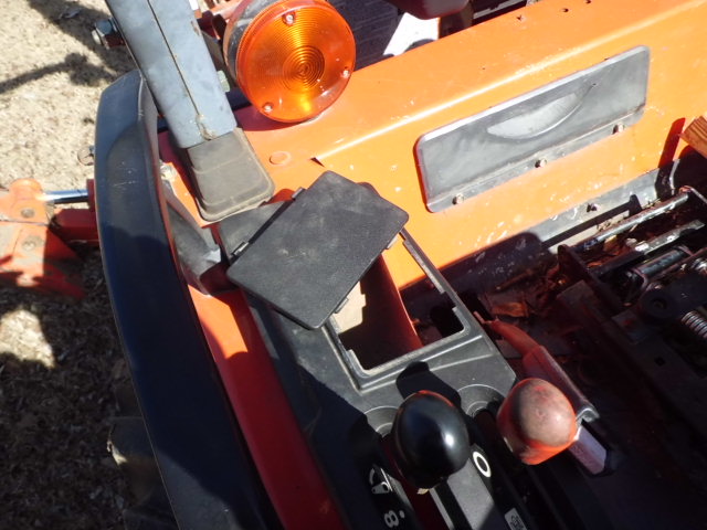

I found a ring terminal (-) and a female barrel connector (+) under the right rear fender, i think this was to power the optional work light, I was all excited until i relaized this ckt is always hot witth the key on. I made a run to the parts store and bought a relay thinking i would control the lights off the lights but after the test drive i think just installing a switch on the ground ckt will be the way to go. I looked at all the switches while at the store, none of them look like they will hold up to living outside. hmmm any thoughts?

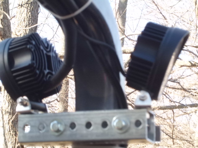

mounting was inside the rops, 2 foreward and 2 facing back.

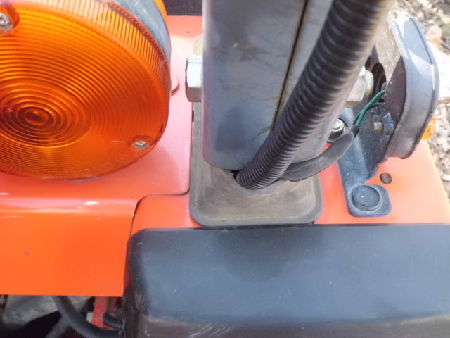

here are the pics, a little jumbled together but you can see the BH light, a comparison between factory light and added light, the brackets built from scrap, switch placement, and the harness run
BH light.JPGbota light.JPGled vs .JPGlight bracket.JPGlights close.JPGnewlights.JPGswitch plate.JPGswitch.JPGwire run.JPG

light switch felll apart after about 3 hours, gonna look for another one that is built a little better. I have been running a medium size cat track hoe for a week, the light switches on it cought my eye.
