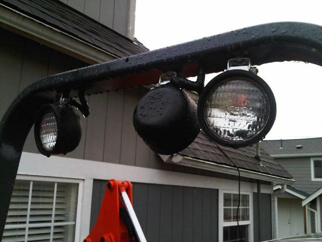

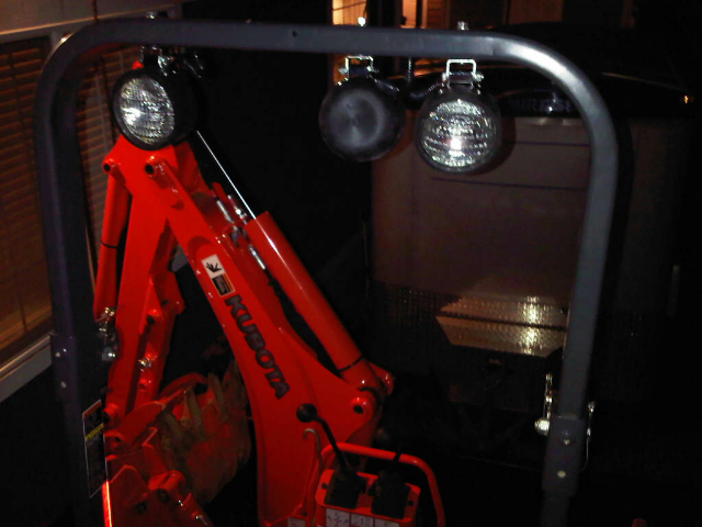

This is how I mounted my lights. I ran the wiring insides the ROPS and left slack to allow them to fold. My LED upgrade is coming soon.
   / b3030 tlb, adding LED lights w/o the upgraded alternator #30
Should never drill or weld to ROPS. It can weaken it.
