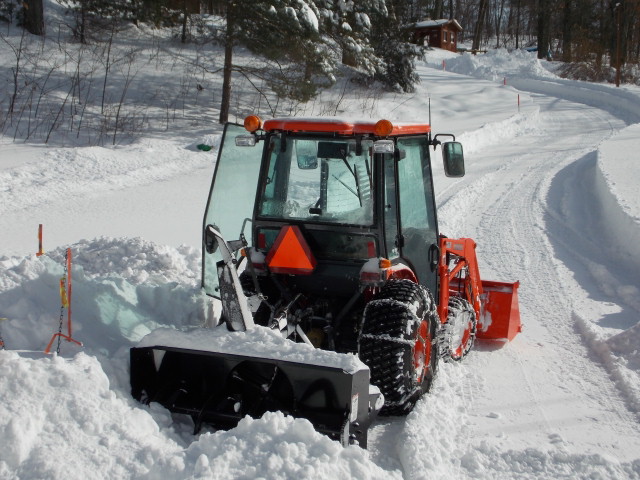

I'm only commenting on this thread because MJ said that his B3030 can't handle a rear snow blower. The blower on my B3030 worked fine last year when we got 30 inches of snow in one storm. In fact, it was a life saver!
As far as his mechanical troubles go, reason might be the fact that he has a crew operating it. Most people had yet to get a tool, tractor, or vehicle back as good as it was when it went out. Some times it isn't even from lack of caring or recklessness. I loaned my brother my chainsaw one time. He thought he would do me a flavor and get it sharpened by a professional shop before returning it to me. It was sharpened at the wrong angle and couldn't cut butter when I got the saw back.
Lesson learned: if you care about your equipment, don't let other people operate it!
