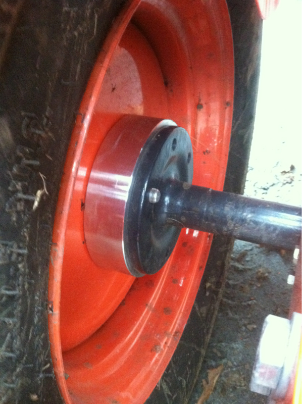

I have a B3300SU & I installed 2" Bro-Tek wheel spacers on the rear so I can use chains in the future if I pull the trigger on a set.

I may make up some wheel spacers if my narrow gauge chains don't hold up or still interfere. I know Kubota was looking to make more room for the operator but really, without designing it for chains in the first place, they are basically making a 3 season tractor and the 4th season is 5 months long up here.
