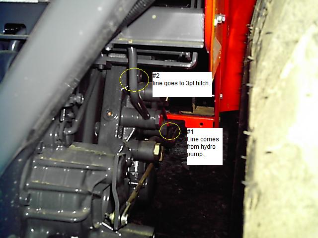

The b3200 only list the front outlet where as the b3030 has both a front and a rear outlet. What size hoe do you have on your b3030?

Rob,
You should be able to just insert it in the loop just before or after your FEL (at the front block). Then just tee your tank return line in with the tank return line of the FEL.

In this picture I followed the lines and the one I said goes to the 3pt hitch goes into the transmision case around the area of the 3pt hitch. I would think it is the line that I should be tapping into. Does this sound right?
Ductape
I noticed in your profile that it was a bh80x right after I posted the question. I aked because I am thinking about used backhoes and your 3030 is similer in size.
Rob

   / b3200 hydraulic loop? #15
Rob, Do you have a dealer near you? When I did mine, I fount a similiar model on the lot with a BH and crawed under and traced the lines, and rough sketched it out on paper.
If not let me know as I drive by one regularly and could probably stop. I'm sure I need something there...
Made life so much easier... Just a thought...

If all goes well I will be in the area of the dealer tomarrow. I am going to price out a loop and get more info on the rear remote kit. My factory service manual should be in as well.

I just bought a b3200 tlb around a month ago, only have 4 hrs so far and this is my first tractor. If i can help to trace out lines on backhoe or send some picture's i could do that this weekend.

That would help me out a lot. I did not make it to the dealer today and might not for a few days. If you can, take some pictures of the hoses that run from the backhoe to the tractor.
