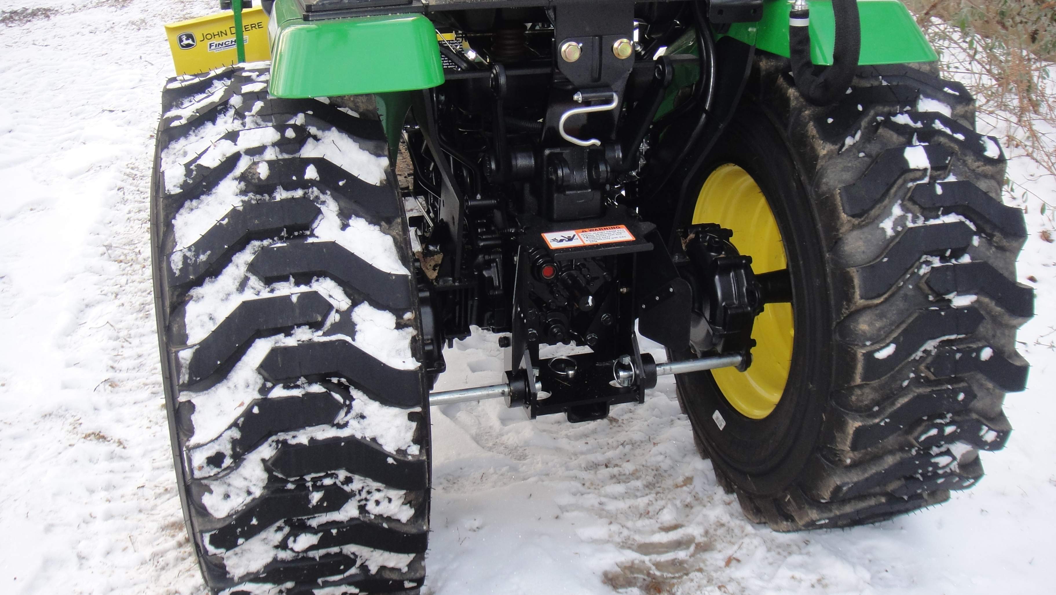

Not sure how longevity and reliability rate on your scale, but that is the top reason I went with Kubota. The Kubota may be a little less 'refined' but they last forever and are super hard workers. The B3200 (all the B-series really) are a very well proven tractor, with the current design having been in production for many years. Take a look at the structure of the tractor also, IMO the rear end on the 2520-2720 is kind of unusual, not sure how it will hold up over the long run.

The axle setup is a little unusual but very strong. I am only aware of one post where a guy broke it and the general consensus was abuse. I believe he had the old style 3PH arms, narrow tires and a loose implement that drove the arms into the tires. Classic immovable object and unstoppable force.

For those of you who are not familiar with 2520 and 2720 rear end axle set up here is a picture. Instead of an axle coming out of the transmission the axle is attached to an external housing with a reduction gear.
