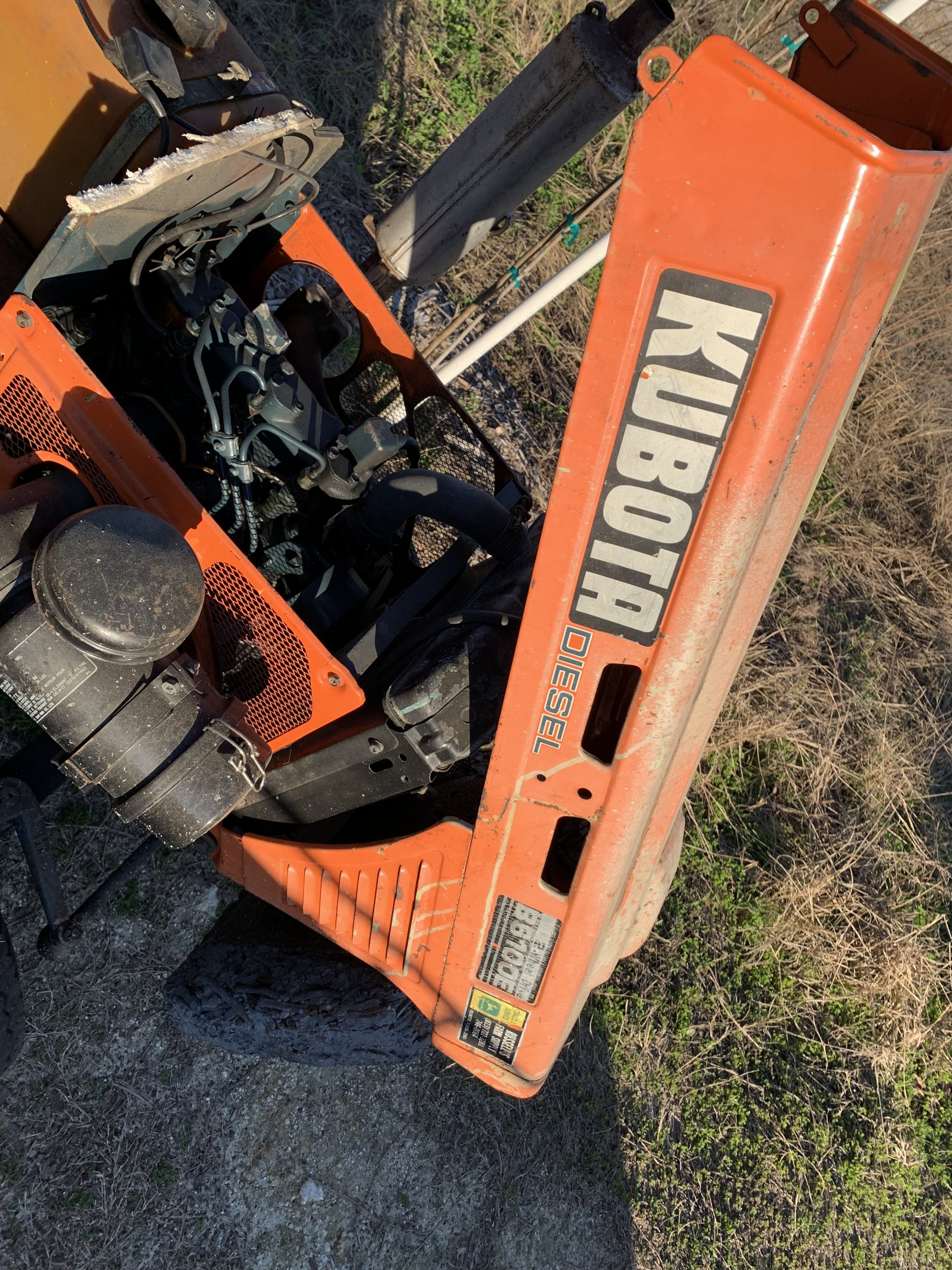

I’m wondering if this thing is like many older cars in that if I disconnect battery and it dies that generally means alt is no good?
Won’t hold a charge, fairly new Wally World batter ( about 3 years old with a 5 yr warranty)
Anyone change an alt in one of these? I have very little experience with diesel Kubota’s
I believe it’s in front of water pump?
No wait there is no water pump is there 🤪
