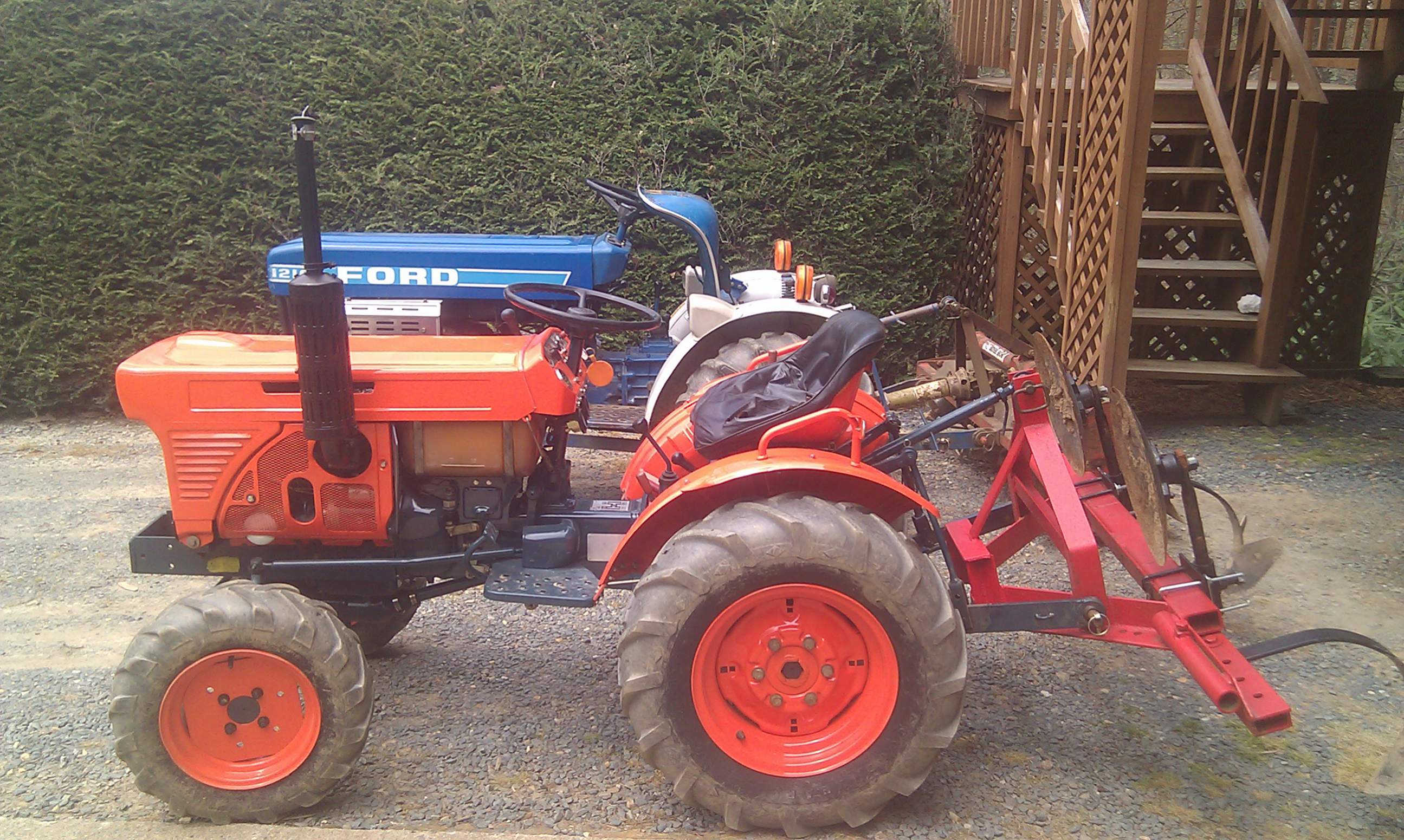

Used it today to plant 1/2 acre of taters. Until I figure out the problem with engine temps while using the PTO the Ford 1210 will do the tilling and the 7100 will do the laying off and hilling using the hiller/layoff plow that I built in 2010.

I notice that the B7100 runs hot and has a lot of black smoke when I run the mower on "high" pto, but when on "low" works great and goes forever. Runs about 210-220 degrees and no smoke. Cuts through high wet grass like butter. The JD with a 709 on the back will cut through tree trunks but not as agile when in the woods grooming trails. Overall, it is a great tool and a good compliment to the big boy.
