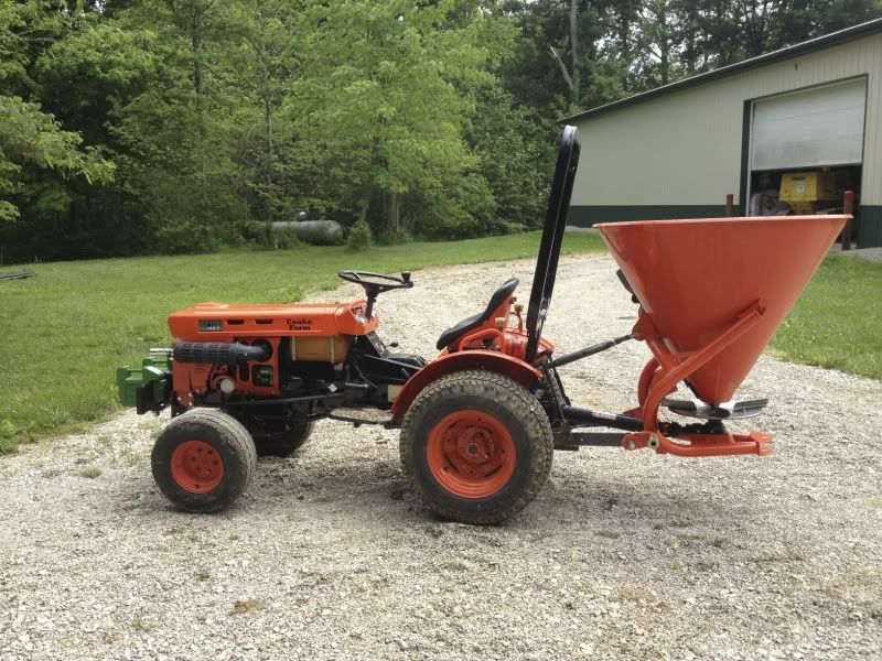

I like your cultivator/hiller, JT. Is that an as-bought, a modification, or a custom built attachment?

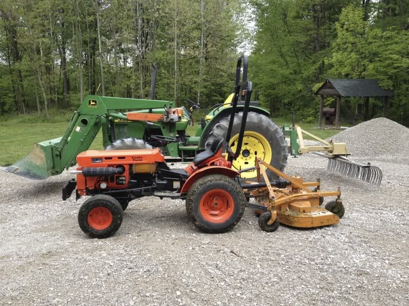

I notice that the B7100 runs hot and has a lot of black smoke when I run the mower on "high" pto, but when on "low" works great and goes forever. Runs about 210-220 degrees and no smoke. Cuts through high wet grass like butter. The JD with a 709 on the back will cut through tree trunks but not as agile when in the woods grooming trails. Overall, it is a great tool and a good compliment to the big boy.
Thanks for the temps. That is what mine runs according to my gauge and is confirmed with the infrared. I hope to find a good used finish mower soon to use on some large areas that I mow with the Cub. I have really enjoyed using mine so far and looks like you have too.
Thanks, I took my cultivator and made a tool bar for it then bought the hillers and fabricated adjustable mounting plates. I keep the plows adjusted to take out the tire tracks and lay off my rows. The hillers can be turned up out of the way when laying off rows.
