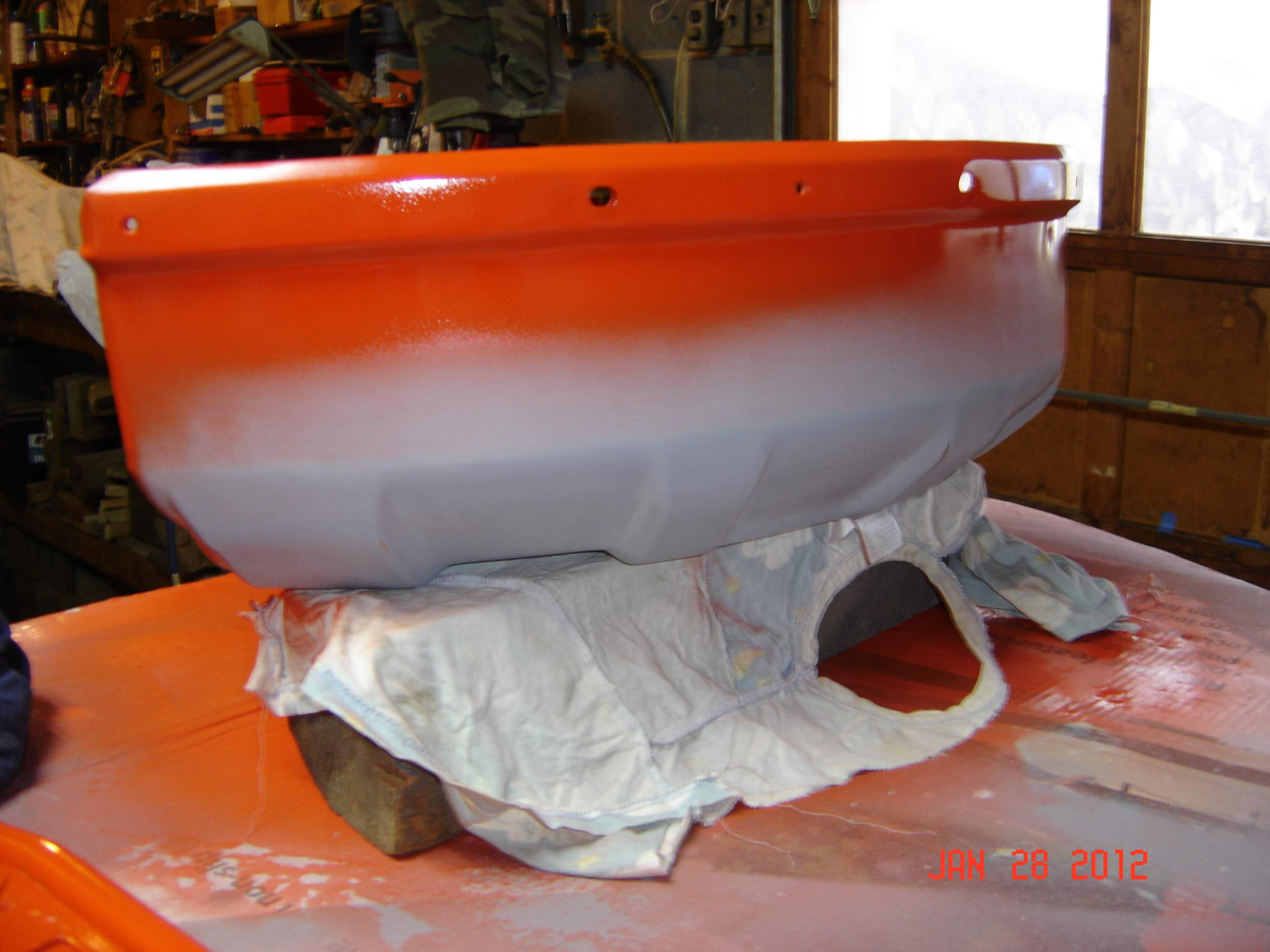

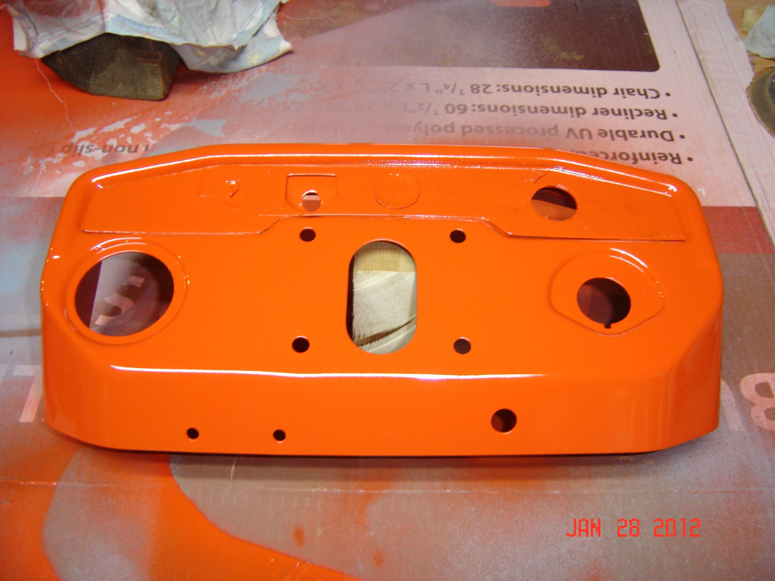

Picked up my pieces from the machine shop on Wed. and got to work. Checked piston skirt and ring end gaps and got the pistons installed. Bearing clearances all checked good. Got the bottom end together by Wed. night. Started early Thur. morning and finished the reassembly and painting. Bolted it up Thur. night. Rolled the front axle and frame into place Fri. morning and made all of the hookups. Fired it up Fri. night. Posted video of the fire up after bleeding the fuel system but the audio did not load so there is no sound. It purrs like a kitten. 40 PSI oil pressure reading on the manual gauge that I installed. Took it out on Saturday to begin the break-in. Now I can find out what kind of shape the tractor is in. Gear noise is more than I like to hear in 4th and 5th gears and is worse in 4wd. Lift works good but leaks down if left up for an extended time. Rear hubs are worn which I already was aware of but didn't know how it would affect the tractors performance. IMG_2130.jpg

Now comes the rest of the restore. Going to break it apart and inspect the gears to try and locate the source of the noise.IMG_2169.jpg

WOW! that is a gorgeous engine. There is no greater satisfaction than rebuilding an engine and having it fire right up and "purr like a kitten". Not everybody can do that and you've got to give yourself a lot of credit. I like the pictures. I can almost smell the oil and feel the plastigauge! I hope I am as lucky as you are skilled when I get to heating up the glow plugs for the 1st time!
Ugh. Sorry about the gear noise. The rear is a little more daunting for me because I know its all about replacing not rebuilding. A full line of bearing separators and a little hydraulic press can be worth their weight. Hopefully you can find a simple "junkyard problem" = "one bad dog with a broken tooth".
