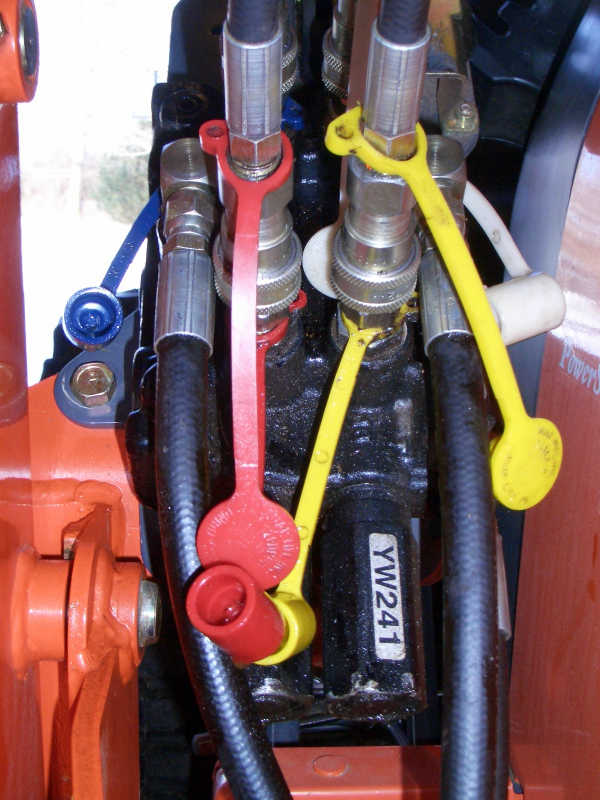

Since they could find no other reference or description to the part #'s, I went out and looked for an outwardly obvious B2006 or B2007 marking. I could find neither, so I took the shroud off the valve to look under. Nothing! Errgh, back to the part numbers in the thread, pdf parts file at the office...
Well did I feel like a real dummy, but it was staring me in the face all along... clear as day even with the shroud on as the pic shows. Guess I was so fixated on finding B2006 or B2007, the YW number just didn't click.

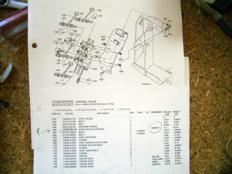

I say it gets interesting because I have neither the B2006 or B2007 valve, but it sure as day is a 4-way valve.
Actually, it is:
- Model #B2009-1
- Part #YW241-00100
While the #'s differ, it most closely resembles the pic of the 3rd part # I mentioned previously, called "assembly valve control".
Attached is exploded pic and parts list with B2009-1 valve.

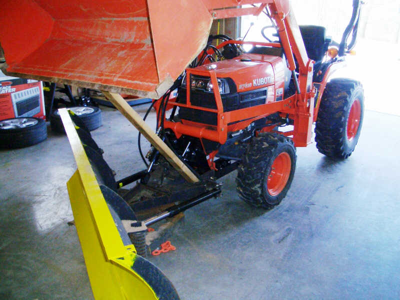

duber - I spoke to a tech who was purportedly the hyd wiz at my dealer and went thru my scenario. He also suggested swapping out the single action side cylinder hoses to the double action lift cylinder valve ports as a test and, indeed, the blade angled both left and right just fine. Now, he was perplexed as well and we began wondering what else could be wrong.
When speaking of the regen circuit and detents, I realized as we were working thru the positions, I couldn't push my control lever to way right, thru any noticable detent click or feel. As Kubmech said, in order to bypass the regen circuit, you simply have to hold far right. Well, in many hours of loader work using the feature, I guess I just slammed it over and never really noticed the slight detent. At any rate, the lever was frozen out and he made me exert waaay more force than should be necessary to break it thru.
So, after a few tense moments and some strategically placed lube, the valve and lever are working fine and the angle cylinders are doing their job properly. Thankfully, no need to push lever up to angle right, etc. /forums/images/graemlins/grin.gif
Proof is in the pic pudding, here's full extension left...

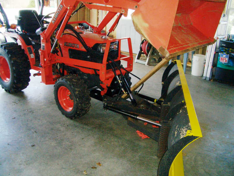

And full right! BTW, the left side angle cylinder hose went to the remaining upper work port on the control valve and the right side to the remaining lower port.
Thanks all for the help, now on to that lower lift cylinder mount.

Interesting. According to my reference material, the B2009 is for the LA302 loader. However my material is over 3 years old and makes no reference to the FL1 variant of the LA352.
