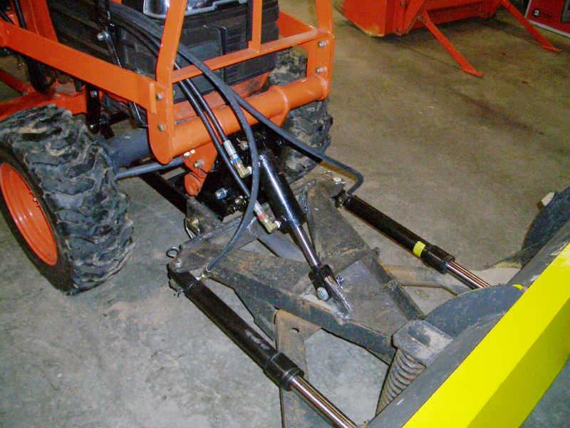

Used the remaining flat stock to make a 2-position lower lift mount last night, although I had to temp rig a bolt until I can find my 3/4" bit to drill out for the cylinder pin! The first position gives good blade clearance height for working purposes, getting over the garage apron, etc. at full up, and the second position gives a few more inches for easy loading onto my trailer for transport if necessary. I did make sure to leave a little piston stroke for downforce.

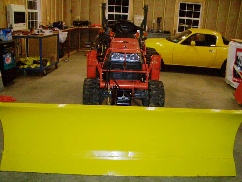

Deerlope is correct, this is a BIG and HD setup for a B7610. But that's GOOD! I wanted a blade heavy enough to clean well on float with one pass, as well as wide enough to make doing my drive in two passes (one up, one back) at full or close to full angle. There is no problem at all with the lift cylinder handling the blade weight. I did find the 60" blower weighs in at about 400lbs and, of course, I'm using the appropriate subframe to transfer forces so I think I'll be just fine.

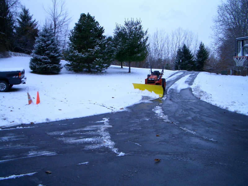

Happy Thanksgiving! I was thankful this am. to find a little of the white stuff to give the new setup a try. Didn't even bother with 4wd or the ballast box, and she worked like a charm. It was so much fun I surprised my neighbor by doing his long drive too!
Bring it on Ol' Man Winter! /forums/images/graemlins/laugh.gif

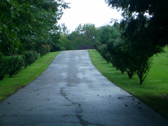

Actually, I did think about Q/A for my loader arms and passed to go the route of the subframe. Why?
- I wanted the plow back closer to the tractor to help prevent side slip with the plow angled into heavy snow, and
- there is a possibility this plow may be a stop gap measure on the way to a front mount blower (which is not in the checkbook right now). One look at the burning bushes that line both sides of our 600'+ driveway makes plowing a PITA --see pic-- so I may need the subframe anyways, and
- my out of pocket on the project is less than $900. IMHO, I got a heck of a lot better plow than the oem setup for much, much le$$. How much would the Q/A hardware cost for everything?
- figured if I decide to let someone else do the plowing or even throw a plow on my P/U some day, I could sell the subframe with male quick hitch and the plow for at least what I have in it, and
- I needed a decent project bigger than an ashtray for my very first welding-related project!
So, with that in mind, this setup is simple, quick and easy enough for me. I can live with it! And, when I get it sandblasted and painted up purty, you will be really jealous! /forums/images/graemlins/grin.gif
