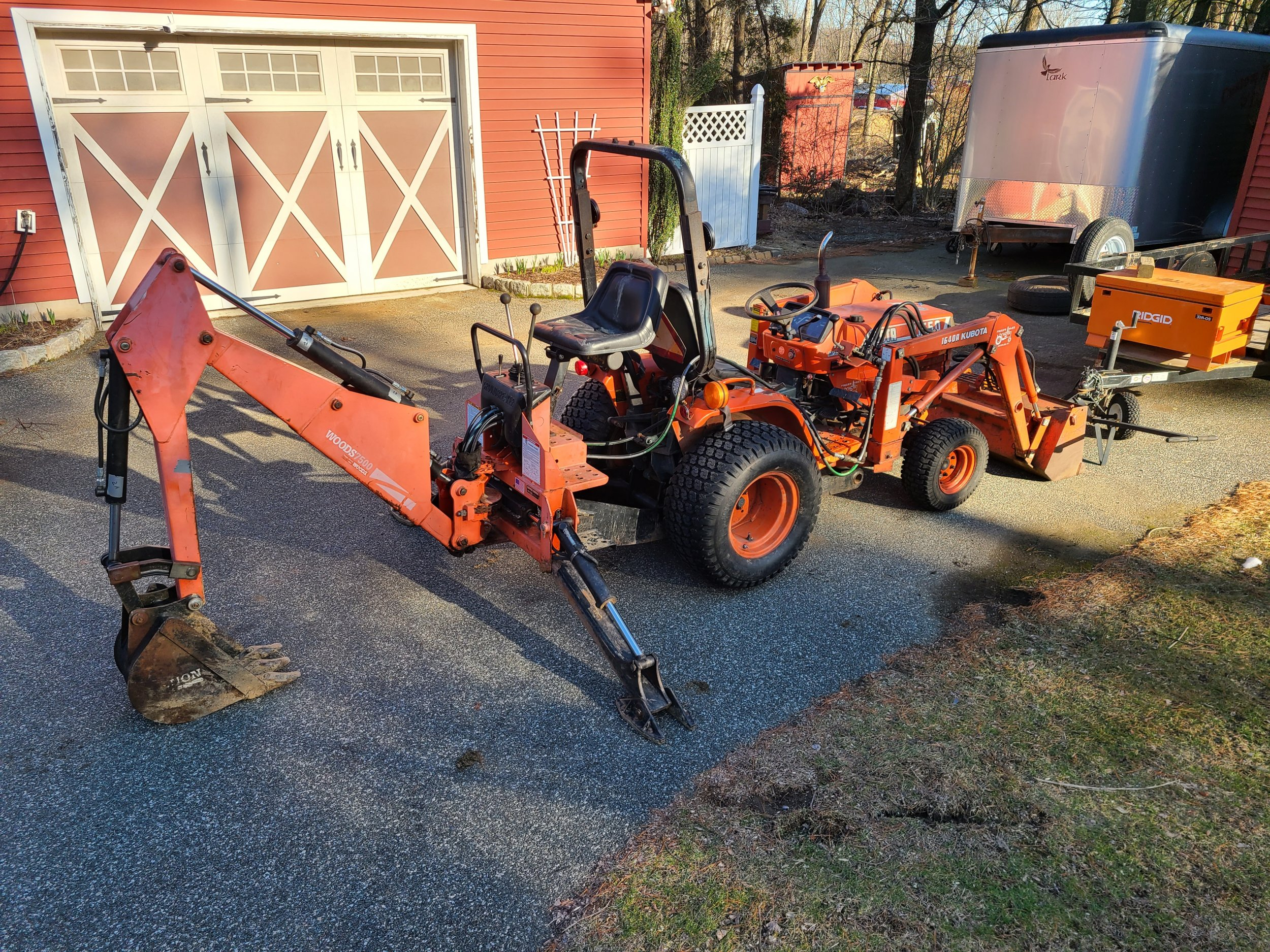

Sub frame is on. I welded the front bracket to the loader frame. No easy task upside down. I also had to leave those bolts out, the sub frame has to pivot to be put on so no way those bolts can stay in. I'm a bit concerned about that. It's to hold the rops on which isn't a problem it's 2 bolts of many, but not sure if it adds support to the axle housing

Love those turf tires. No comment on the inverted welding.....
Surprised at how far to the rear that subframe puts the backhoe.
Need the room for the seat

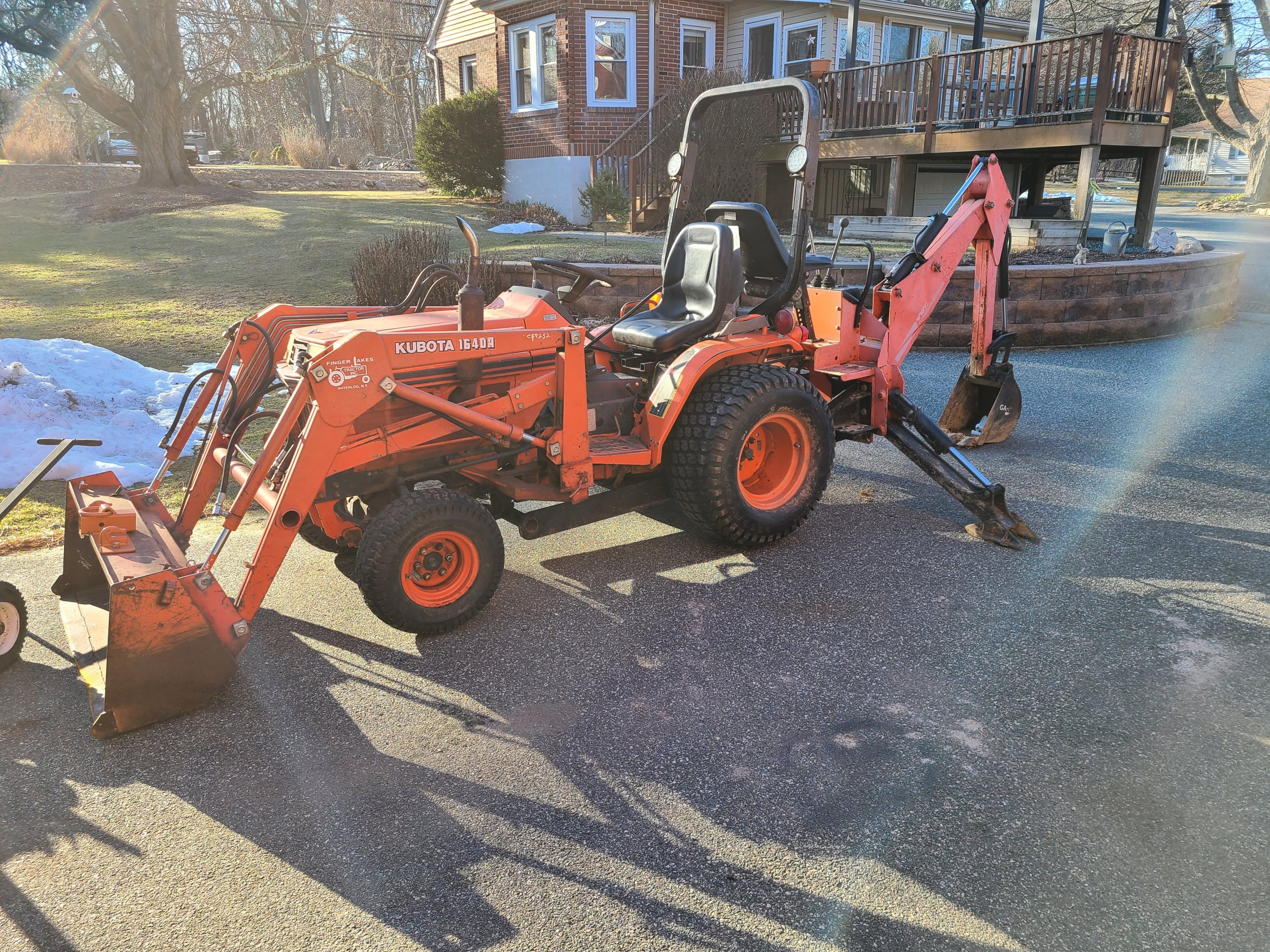

Well here it is peeps. Everything works. Only problem is my head hits the rops so I have to bend forward a bit or hinge the rops forward. And definitely need a bit of ballast in front bucket 😆

Looking real good - nice work getting it mounted too. That PTO pump is a good deal and would be nice to have options for connections.
   / Backhoe attachment #68
Good job on getting it attached! Have you tried digging yet?
