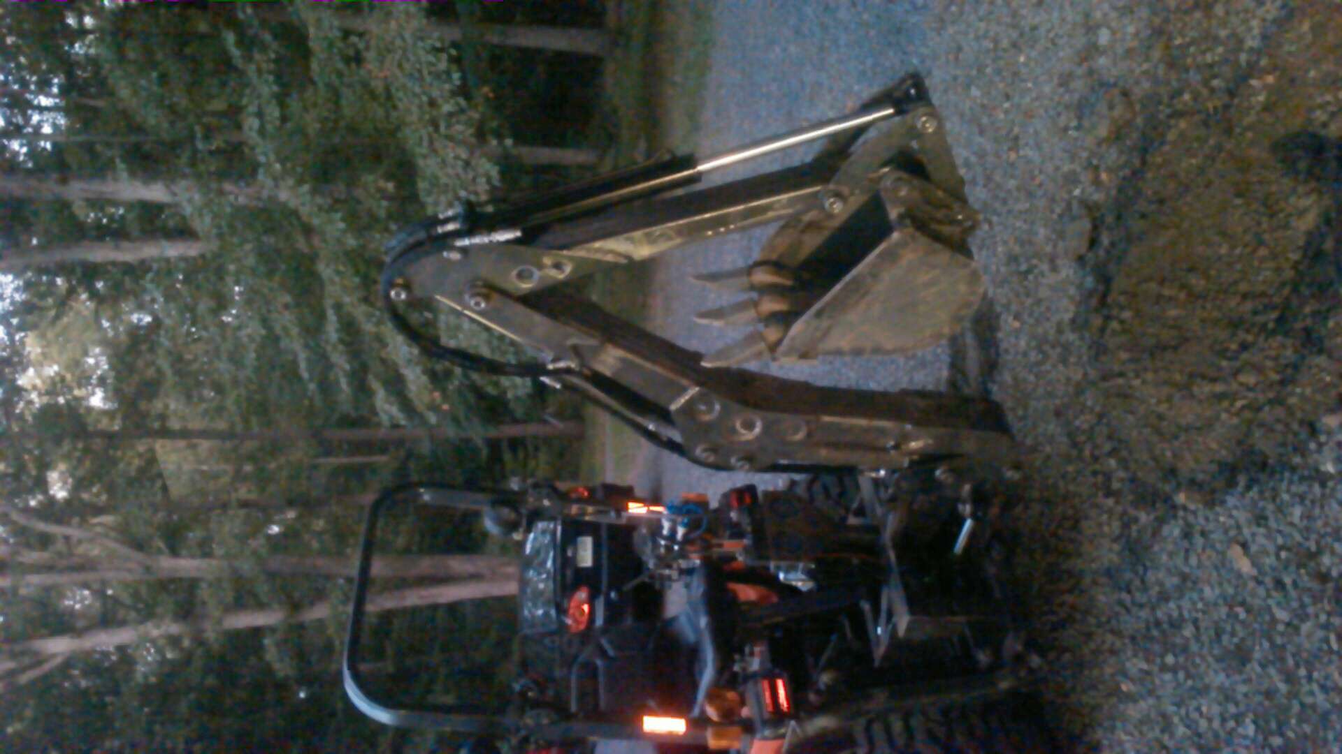

I recently purchased a mini tlb an allmand 535. It has an 18" bucket on the backhoe. I need to change out the adapters and teeth, I removed what was there and now only have the bare cutting edge. I purchased cat j200 series theeth and adapters. I was wondering if they are too large for my application and what are the downsides to having too long of a tooth. Should I return them or get something like the x156 tooth. Thanks

I know they are big but are they too big for my bucket

I’d get smaller ones. JMO
   / Backhoe Bucket Teeth #6

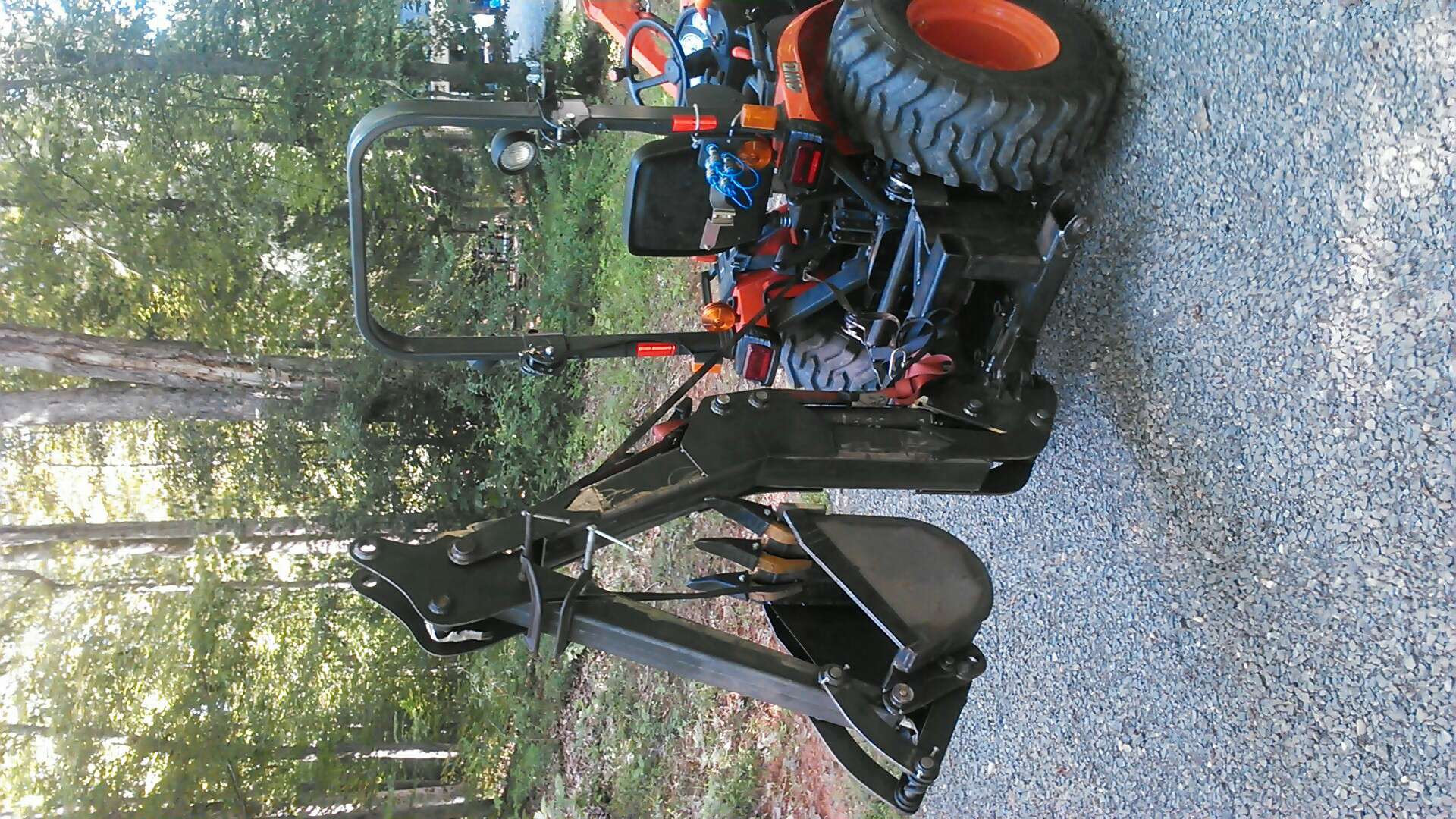

I'd try to go smaller, I have a similar size bucket with a tooth that appears to be smaller then yours and its too big for me.NCM_0872.JPGNCM_0794.JPG

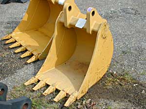

If you're going to use the hoe to dig ditches (trenching) have the two outside teeth pointed out past the edge of the bucket. It will help to keep knocking the edges of the ditch back in the trench on each stroke. 24in-CAT420DE1.jpg

If you're going to use the hoe to dig ditches (trenching) have the two outside teeth pointed out past the edge of the bucket. It will help to keep knocking the edges of the ditch back in the trench on each stroke. View attachment 589553
I was going to point that out. Also it will prevent premature wear on the bucket sides. You want the bucket teeth to do all the ground breaking, not the bucket edge.
And yes, I would recommend to go with smaller teeth also.

I put a set of double point teeth on mine and that seem to tear up roots better. When I bought my backhoe they had a piece of grader blade welded across the teeth to make it a straight edge bucket. Cutting that off and adding teeth made a HUGE difference. To the OP I’d get shorter teeth. You’ll loose breakout force with those. And it looks like you could hit the stick with those.
#13
thanks to all, im getting the smaller x156 teeth with the x835-156 adapter
