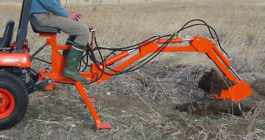

My point was to make it clear that it was a 3-point mount BH with a stabilizer kit because the question was asked about a subframe mounted BH. The is another company that does make subframe mounted BH for many different small tractors. The company is called Kwik-Way. Kwik-Way ,they don't show one for a BX on the web site but they do make a loader and and BH for it. You have to call them for liturature.

jrlichina ,
I appreciate the picture you attached. I am just a little confused regarding this BH. Is this an BH available for the BX2200 and if so what is the brand and price?
Krecker
   / Backhoe for BX2200? Is there? #25
Hmm picture or did you mean the link to Kwik-Way. As I indicated in that post the web site doesn't show Kubota in the tractor company list but they do have one for the BX. They are very slow to update the website. I have called them to get printed liturature on the BX stuff. If I remember correctly the loader goes for like $2,700.00 and the BH is like $5,800.00
