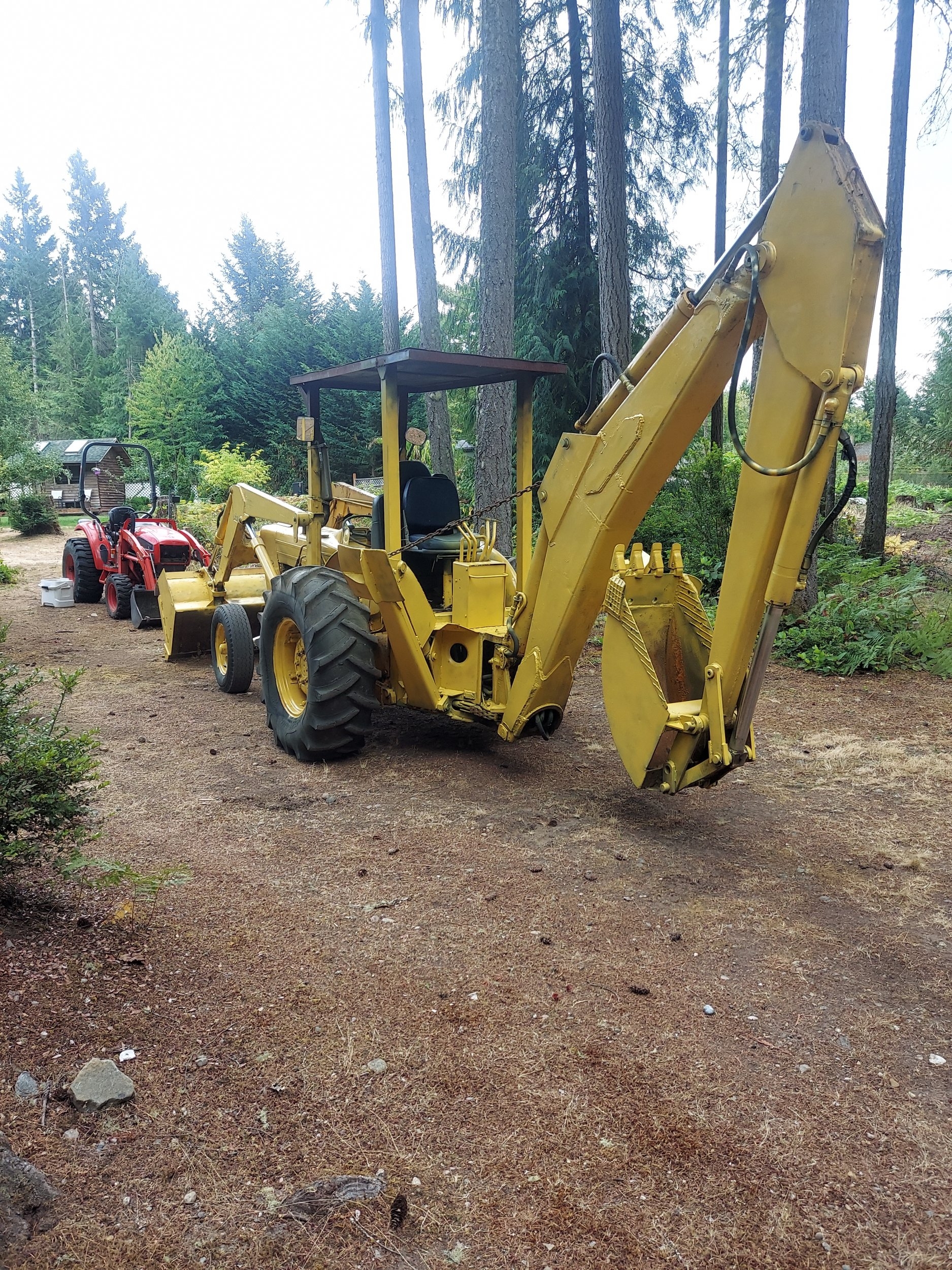

Hello tractor gurus . Kind of a newbie didn’t grow up with this stuff . Bought my first tractor at about 60 years old.own a Kioti 26 and an old Ford 4500 industrial with 755 backhoe .Just pickedup last year for 2 grand .new injector pump starter.added Silverado seat an boat seat for back hoe .running great. Knew I was gonna need new hoses eventually.Welove it
happened , my first attempt at stump removal .was going well two digs got a12” rotten stump .one more dig for roots bam.ok question. I’m gonna replace all those four that go underneath and to the manifold .any advise and suggestions. Question 2 Has anyone changed the four lever control to joystick. I’m never going to get the hang of it.

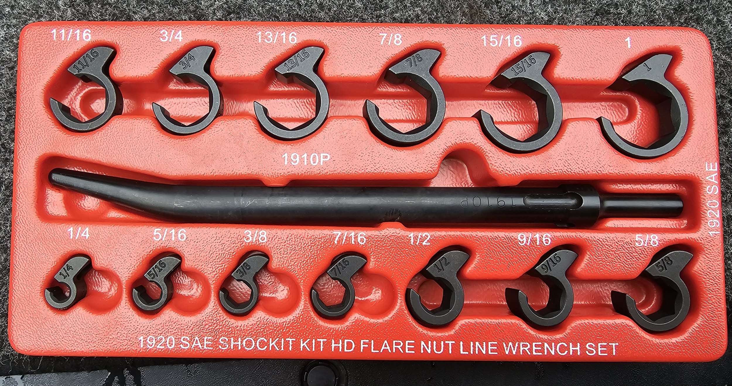

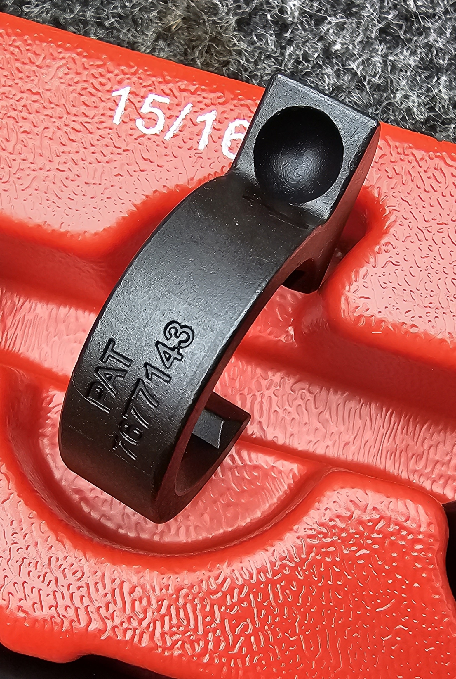

I picked up this set, worked great on my backhoe in the tight areas. You use it with an air hammer and the offset punch tool. Sold by Milton.
