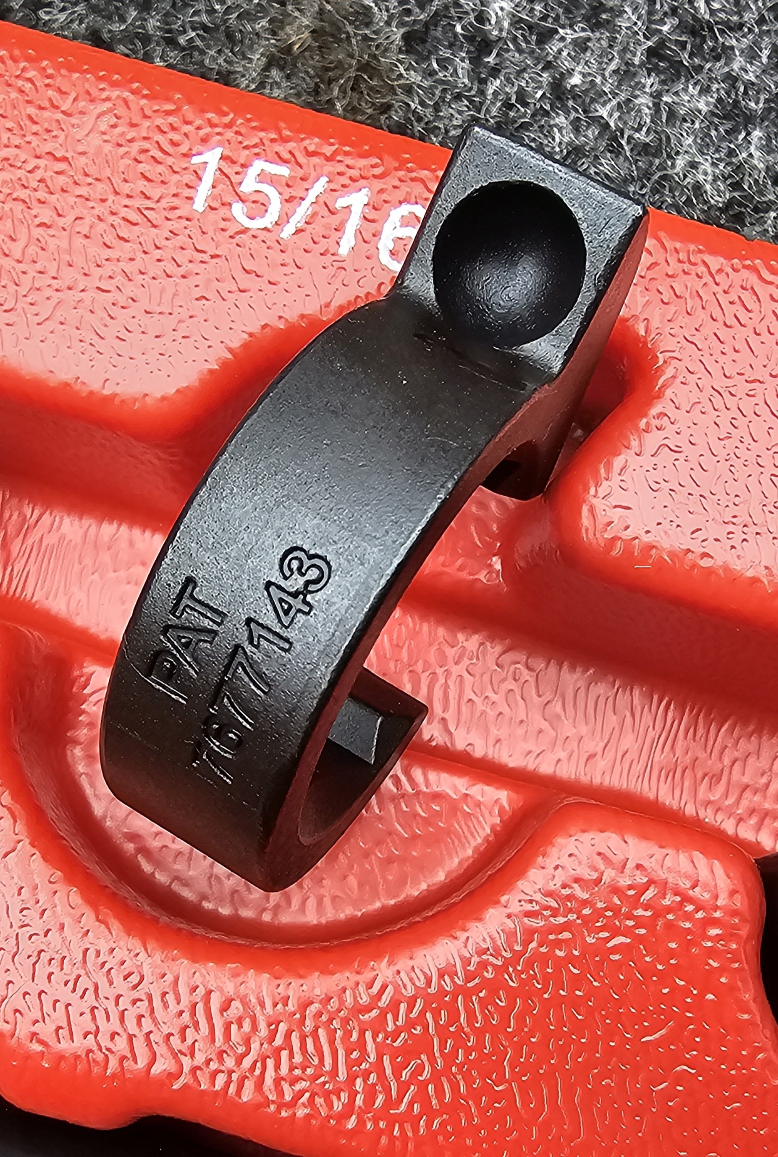

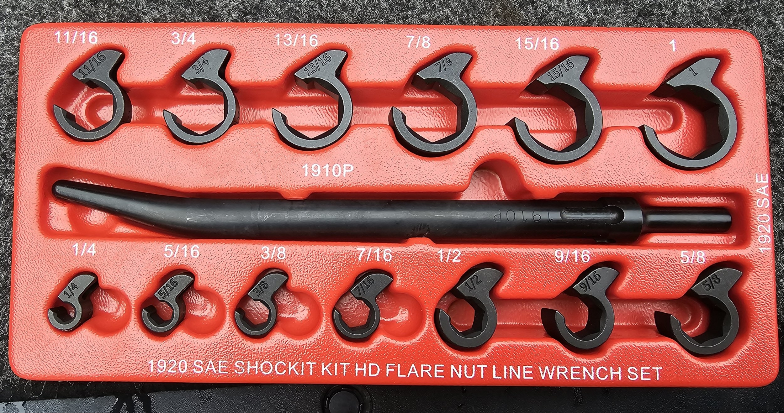

I picked up this set, worked great on my backhoe in the tight areas. You use it with an air hammer and the offset punch tool. Sold by Milton.
