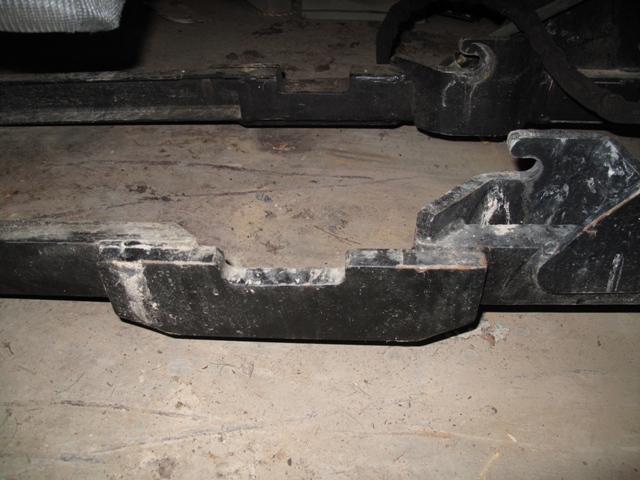

"My dealer made a small modification to the underframe of the BH mount - two small notches in the frame were cut and then additional steel was put to strengthen this area. This was done with Deere support for modification, when I originally bought my 2520."
Pictures are definitely needed.
   / Backhoe & MMM compatibility issue (2X20)?
#12
Ther ya go bkennedy! People want to know.
I would like to see too so I can twist harder if dealer acts clueless or uninterested in investigating this approach.
It's really a shame that Deere doesn't design this modification into this setup. Have to wonder how many people may not buy this size c.u.t. from deere for this very reason. I am serioulsy pondering my options if I can not obtain this mod in a warranted/Deere approved fashion. Not sure I want this hassle of removing mounting brackets.
Before anyone hits on me that it is not that difficult....
I'm a very spontaneous person when it comes to work (probably partly because my time is so limited....everyones is I'm sure). I run out to barn to use backhoe and realize I mowed last weekend, I may not have time to climb under tractor and remove stuff, put it somewhere for just a couple hours of excavation. Next week encounter problem in reverse. Sneek home with an hour before dark and have to first reinstall brackets......
OK I just made a simple little comment and look what happened......
I had no idea there was so much interest. Sorry, working too much all weekend, didn't see the questions.
Attached a quick picture of a section of the underframe.
I don't know if this answers the question. I certainly have to take my mower deck off to put the BH on, but just the deck.

   / Backhoe & MMM compatibility issue (2X20)? #20
Good information.
Thanks, BK.
