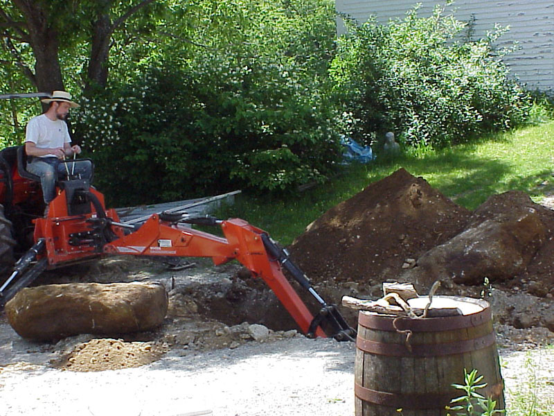

Sorry about that! 'shoulda done a little research before attributing Harv instead of you. Attached is a picture of the latest project - along with a Lyndeborough nugget about 3 feet by 4 that the 'hoe pulled up easily, but the bucket couldn't lift!

Wow, looks just like the nuggets we have across the brook here in Mont Vernon.

Is that a Woods 9000? Nice BH. The 9000 is a nice step up from the Kubota 4690 and Woods 7000. That's one of the benefits of the L's

I have installed both Woods 7500's & 9000's on L3710 Kubota's. The 7500 does look a bit small on the machine and the Woods Subframe does overhang the rear of the tractor quite awkwardly. You also lose alot of ground clearance because of the subframe making it very difficult for those who have to unload their tractors off of trailers in customers driveways. Three point hitch mounted backhoes are hard to attach to newer Kubota's which use the telescopic type stabilizer brackets. It is impossible to eliminate all side to side play leaving a sloppy connection to the tractor. One way to correct tis is to replace one side with the older style turnbuckle type stabilizer chain. I have been happiest with Bradco's frame mounted backhoes. Their units fit snugly to the rear of the tractor's as they should. Proportionaly, the 8' Model 408 & the 9' Models 509 & 609 look very well on the tractors. They do cost more than the Woods hoes but when you compare the quality it is understandable. Hope this helps and good luck......
