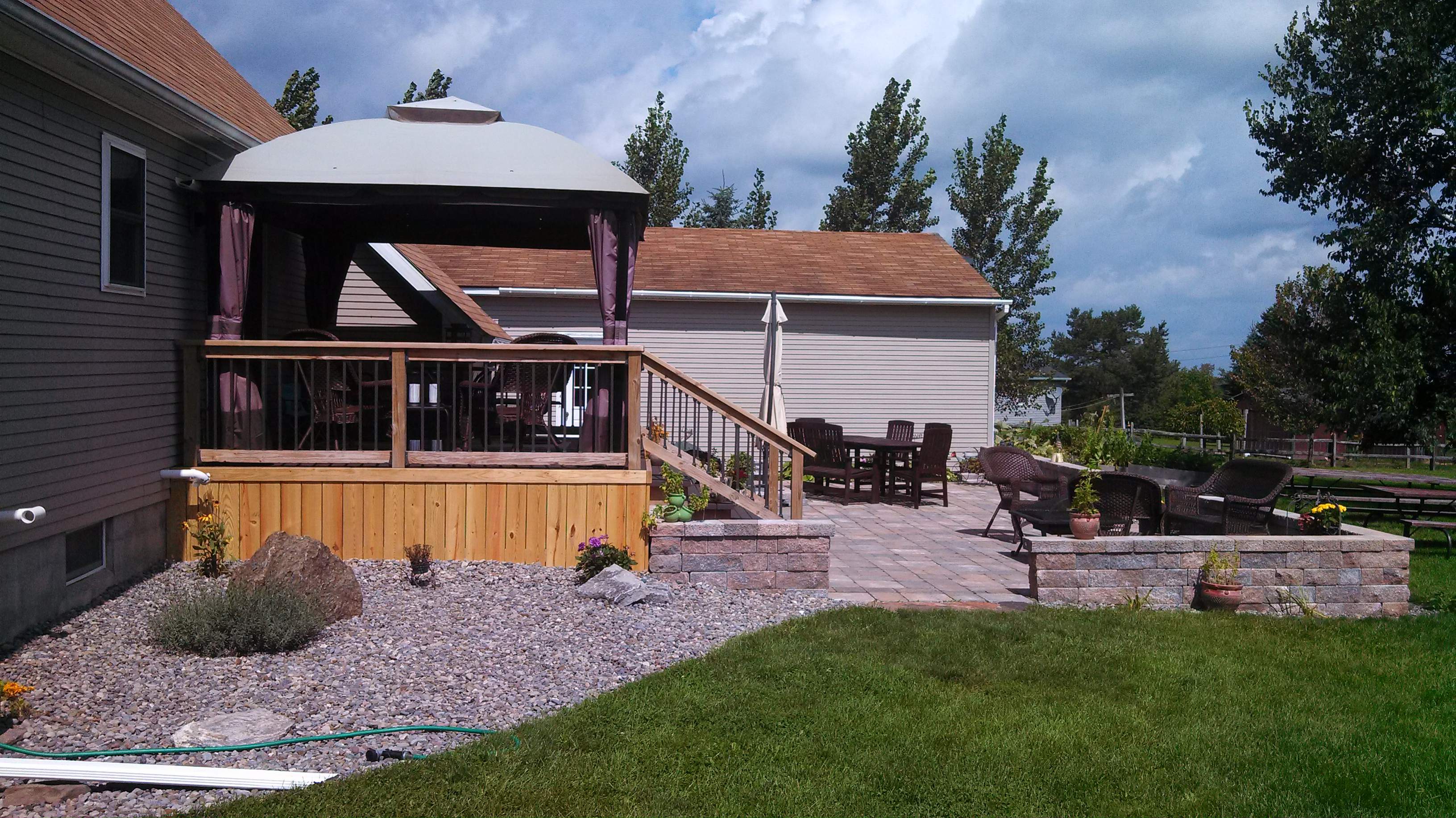

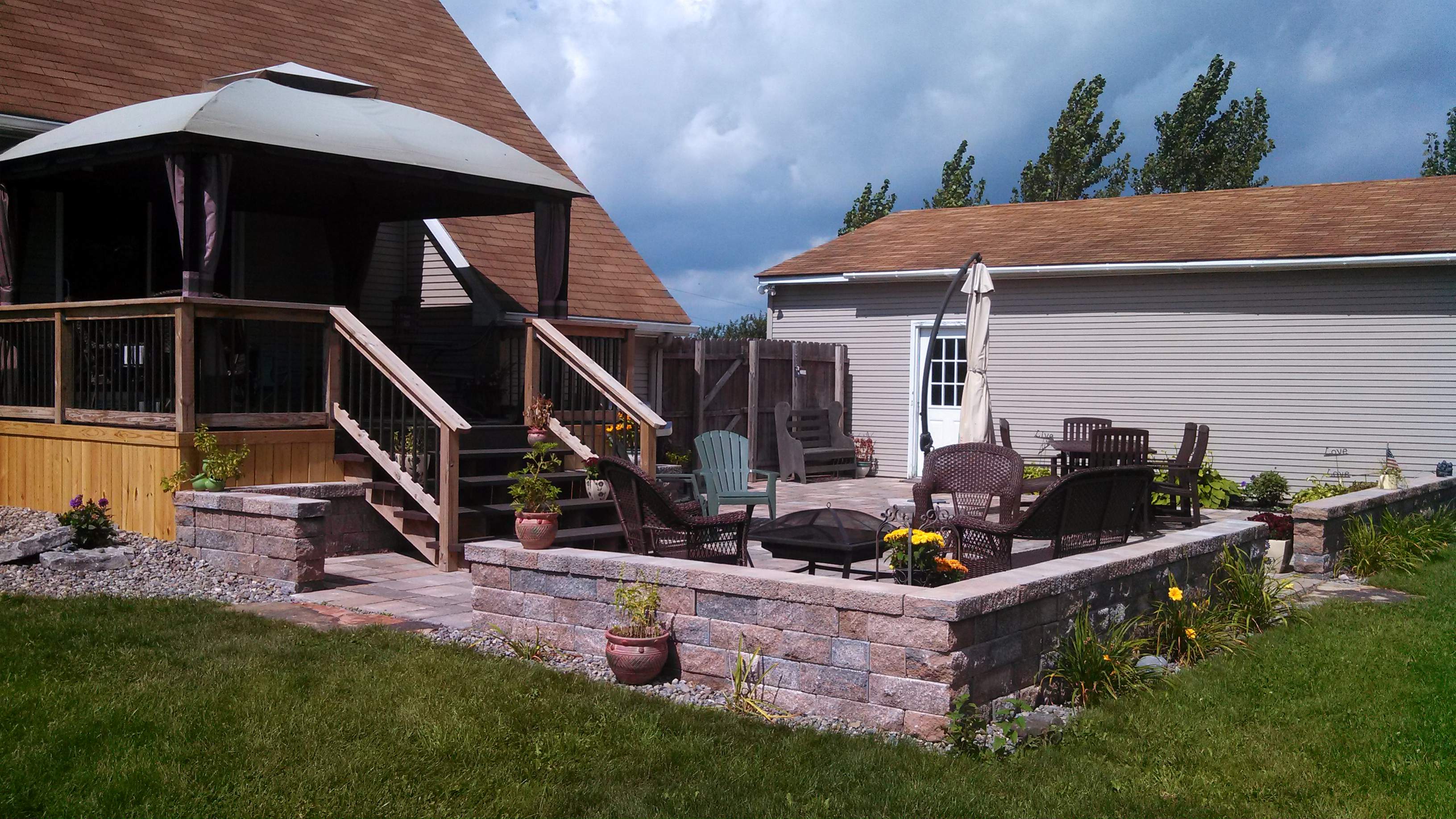

here are some updated pictures
deck railings are finished, we have a canopy/gazebo on the
deck, makes it nice for real hot days or light rainy evenings.
finished the led lights around the inside of the wall caps... beautiful. also
finished skirting the deck, and we stained the deck floor a chocolate brown... glad
most of it is covered on hot days,,,,
