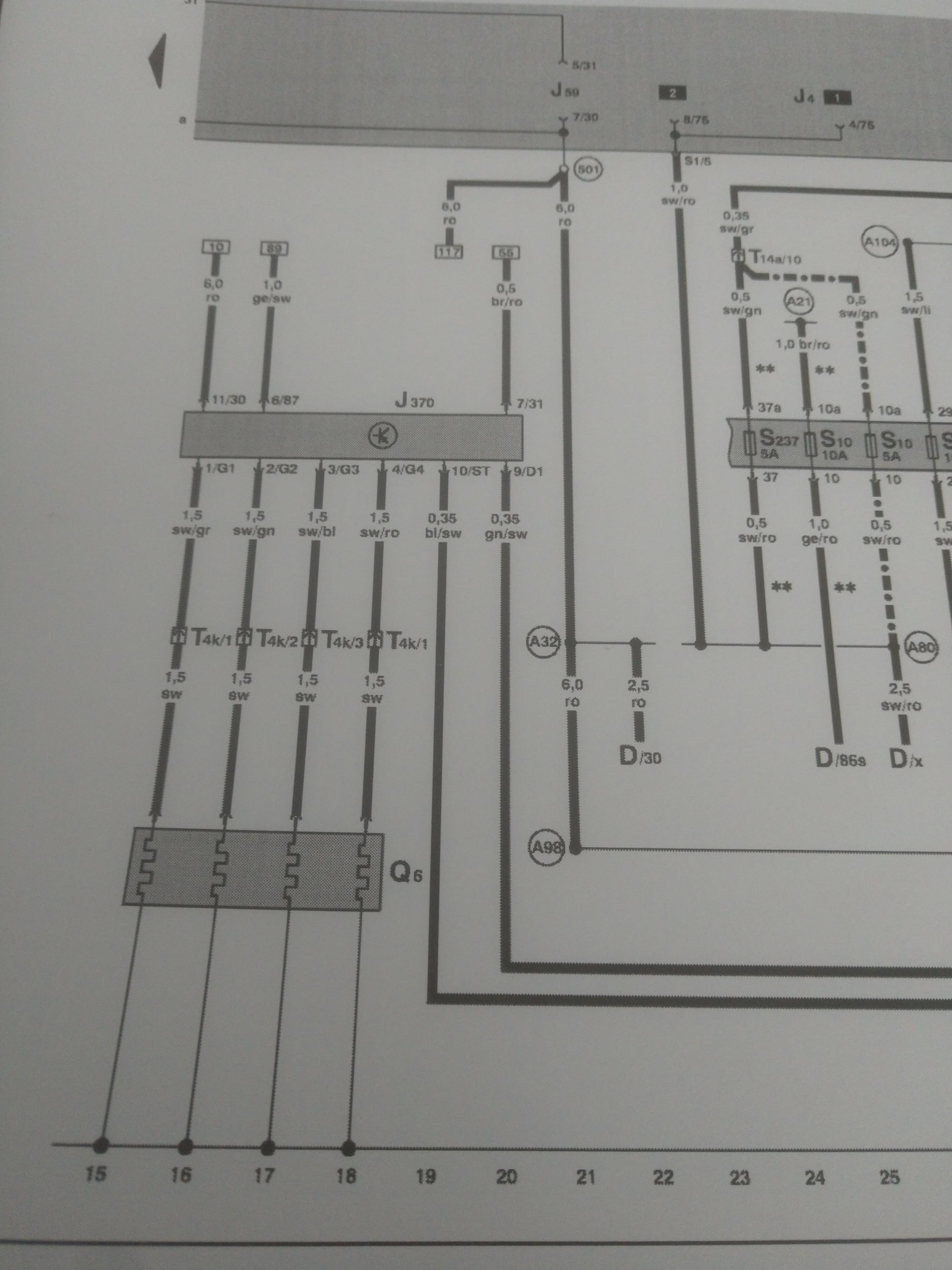

I have a 2003 VW TDI. My engine computer said bad number 3 glow plug. Indeed the ohm meter reading was high on number three. How did the computer know which glow plug was bad and turn on the warning light? The glow plug harness has 4 wires. I assume one for each glow plug. Note that each wire is less than a tenth of an inch with insulation so not very heavy wire gauge. The wiring diagram lists them as 1.5mm. The supply to that module hidden inside the ECM box has a 6mm red wire feeding it, a positive and negative for the relay, and two small wires out that go to another ECM module that tell it if the glow plugs look good. That rambling led me to the conclusion if my glow plug relay buried inside the ECM went bad I would need to have 4 jumper wires not wired together on the glow plug harness or the ECM would toss a code for glow plugs not showing correct resistance. I suspect you could jerry rig something but it might be 4 relays added to the glow plug wiring harness so it does not read incorrect resistance readings from each individual glow plug. My picture of my VW wiring diagram. On the bottom is just ground to the block for the glow plugs. I would suspect your tractor is doing a similar thing. As others mentioned, I think the glow plugs are supposed to operate for 10 seconds before the engine starts and run for a short bit after the engine starts to help ignite that diesel mix until the cylinders and pistons warm up a bit from combustion heat. Apologize for Captain Obvious comments especially if you have a good wiring diagram for your tractor.

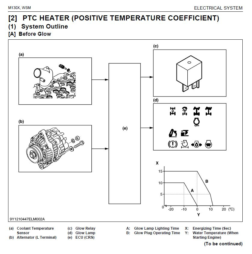

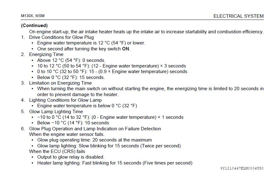

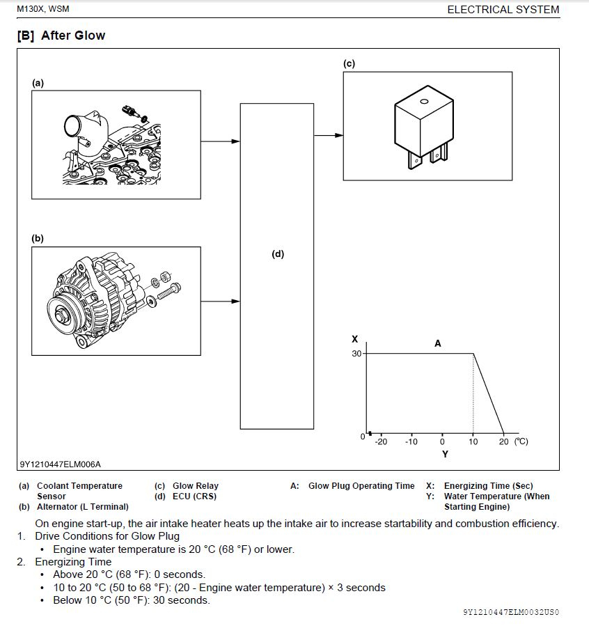

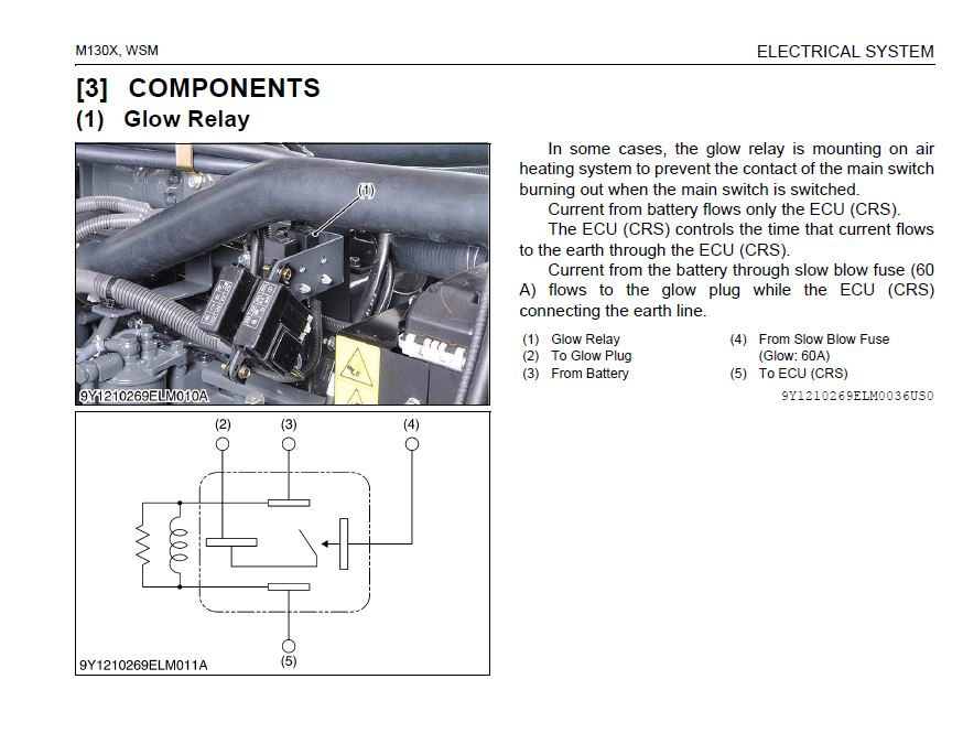

There is a manual for a m130x at Scribd. Pages 458 to 462 explain how it works on a 130. It suggests it might be simple to do a momentary button to supply relay control ground on picture 5 terminal 5. Maybe the 135 works the same.
