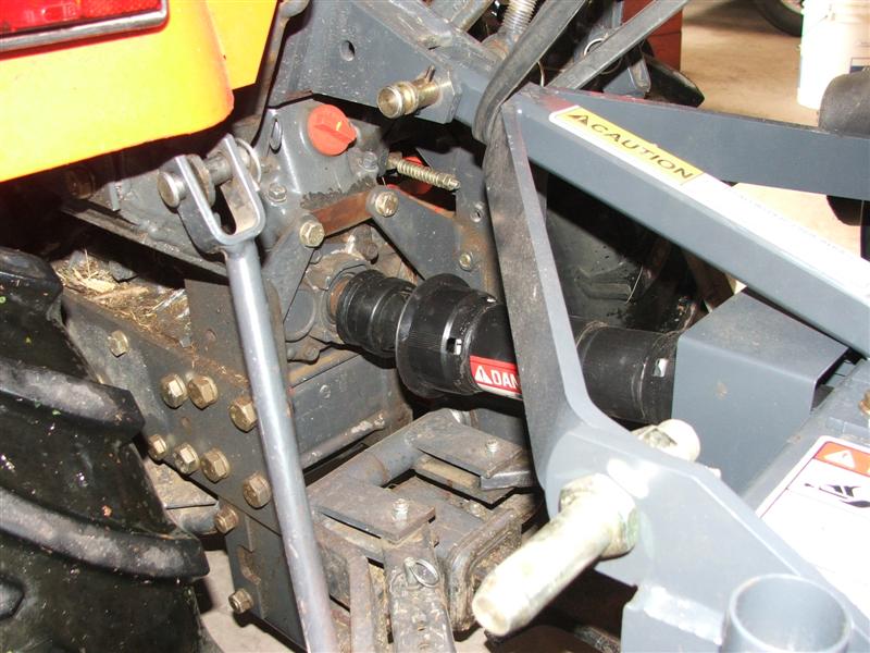

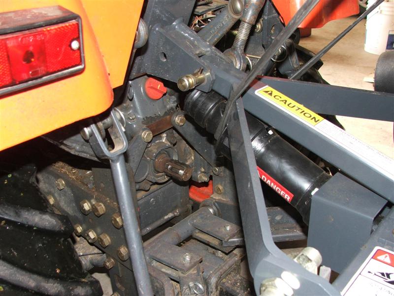

It's hooked in the lower lift arms, just tilt it forward and insert the top link pin and connect the PTO.

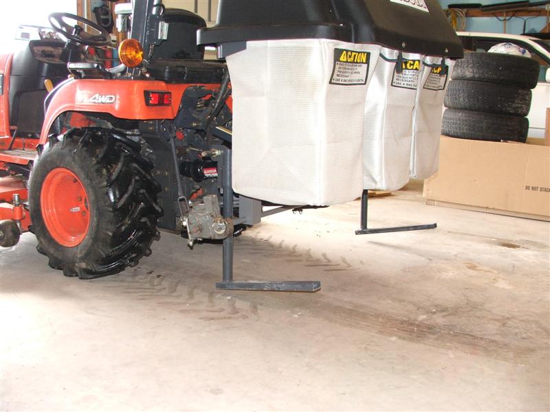

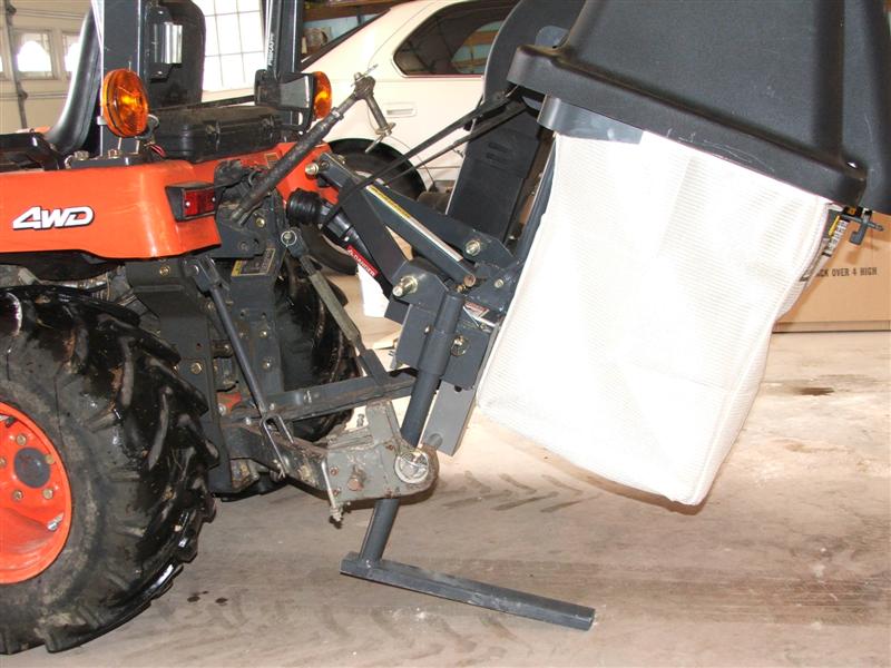

All ready to suck. Don't forget to raise the stands, did that once.:D
