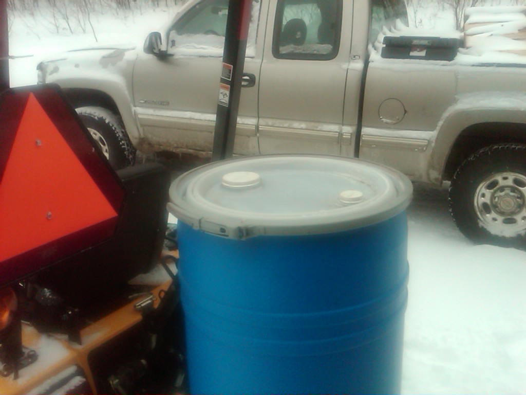

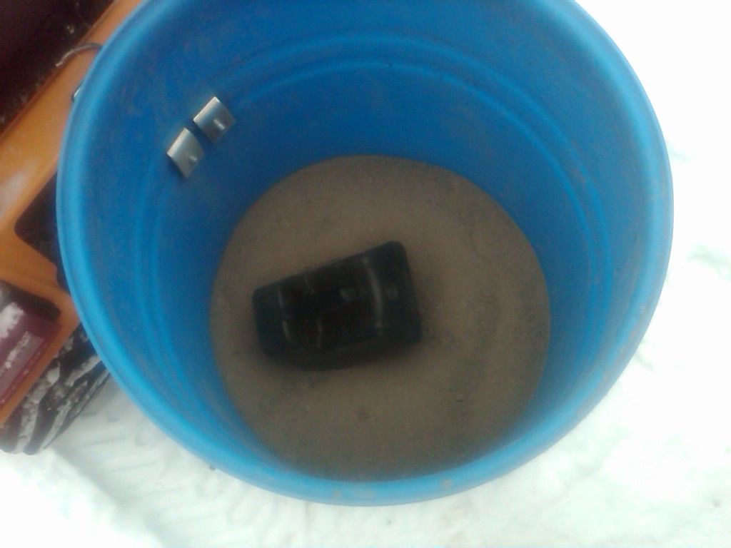

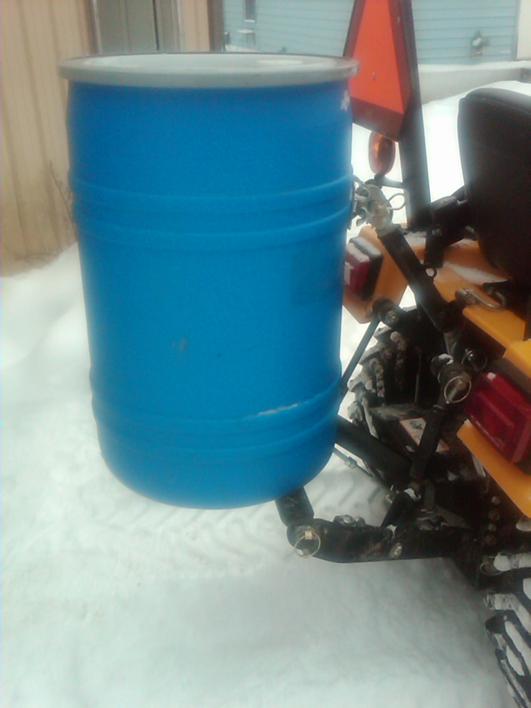

Allot of great ideas here. Something that I found useful was to use a 30 gallon plastic barrel, mount it on a draw-bar from TSC and use dry sand in it. I can adjust the weight for what I'm doing whether it's counter weight for the front bucket or the front blower. I use the sand to combat ice when needed. I was lucky enough to find a barrel that has a ring clamp that holds the top on which is rain tight. I keep a feed scoop inside the barrel so I can throw some sand around the driveway when it gets icy. My tractor is a SC2400 so it's not real big, but it sure helps to stabilize it when hauling gravel around in the bucket or when using the blower.---DTS---
