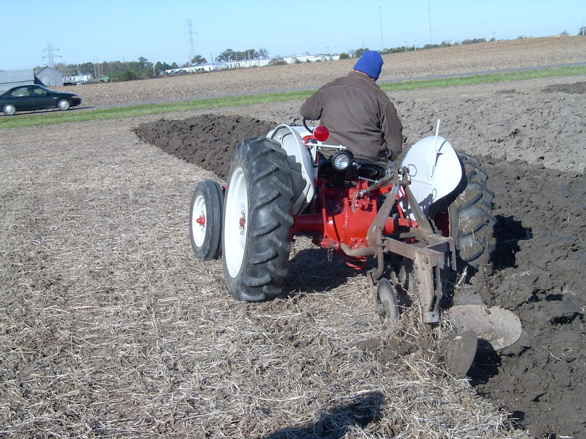

Filled tires are great to aid stability to a tractor...not much for traction though (although I'm sure filled tires to add to traction).
Filled tires on my 8N are night and day. Makes a BIG difference in traction. On plow day, impressed many folks with larger JD's, AC's, and Cases. Philip.
Y'know...after thinking about it, I don't think I've ever used a tractor that didn't have filled tires (with the possible exception of an old Farmall my father owned many years ago).
